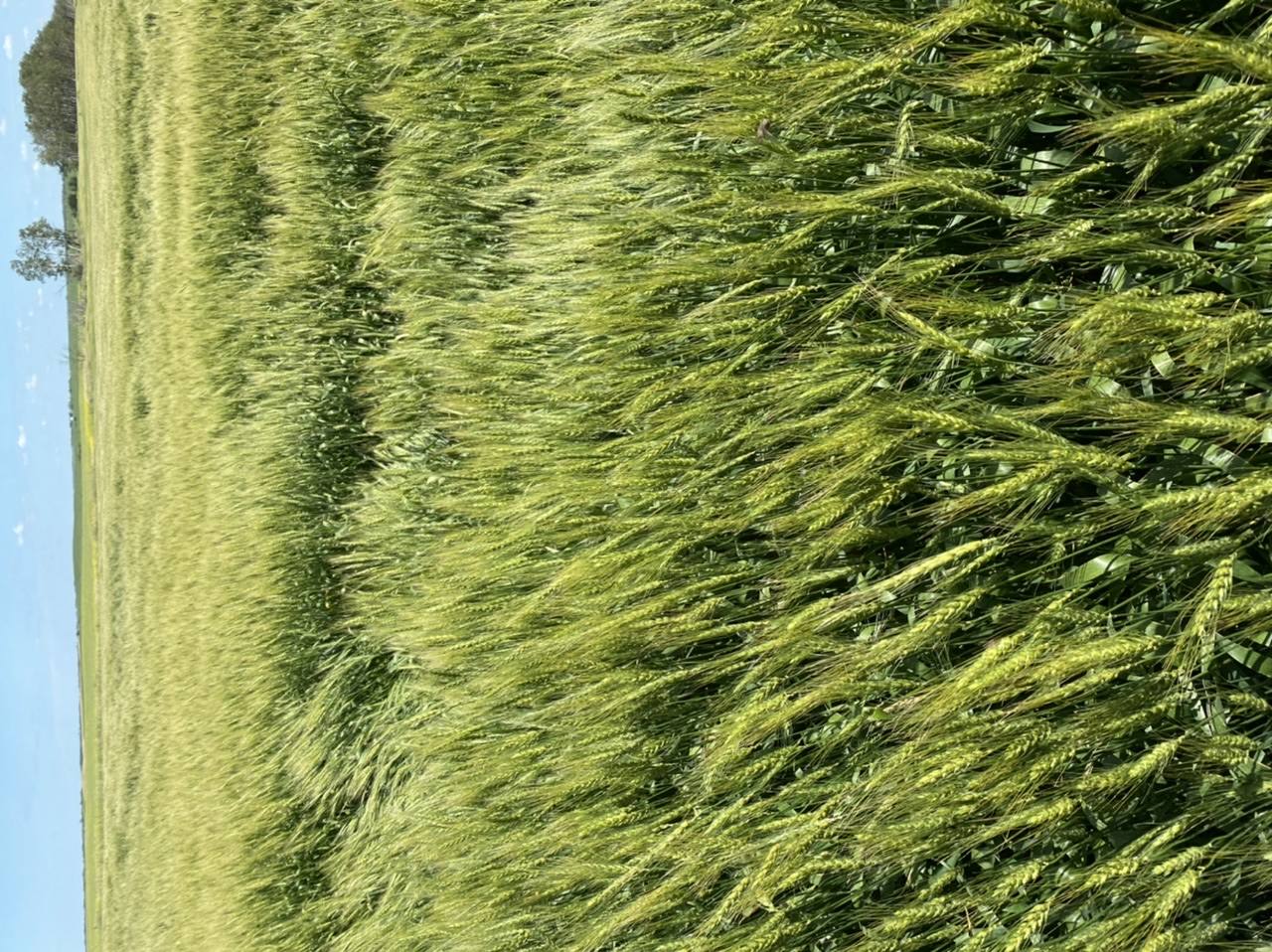

    Wheat is starting to turn fast on early seeded fields. The last seeded are filling and changing colors.

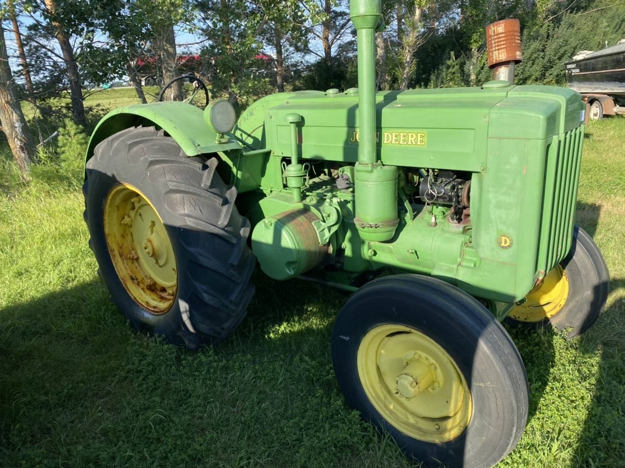

    I did do some driving this week as I am on a mission to get a few more old tractors for our collection. So far I bought a real nice styled D with starter and Pto and a Diesel 3020, I lost the diesel gas but am still the top bidder on a Diesel 4020. Missing a 5020 and 6030.

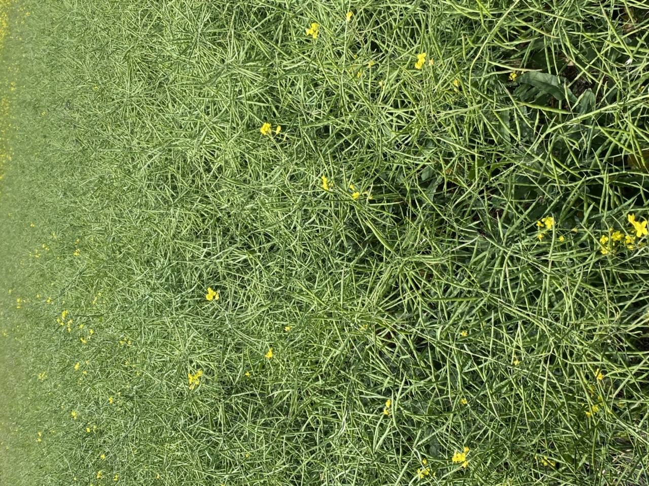

      The crop in our area that is all over the map is canola. The crops that germinated decent and avoided the worst hail are done flowering and look amazing. Then we have the crops with spottier germination that still have streaks of flowers through them, these crops have filled in but the yield will just be average to slightly above. Then we have the crops with more hail damage. Seem to be getting more flowers instead of less. Will need lots of time to finish. Overall at this point it looks like canola will certainly out yield last year.
      Cereals certainly look good, it all comes down to how much hail damage. We are silaging a hail damaged wheat crop right now, looks like it is going close to 6 ton per acre. Viewfield wheat, I was surprised, I thought it would go closer to 4. Forecast has lots of sun and heat, crops finishing fast.

          Cereals look good.
          All canola varieties have tall plants sticking out with very few pods or no pods..
          Yields will be a surprise..

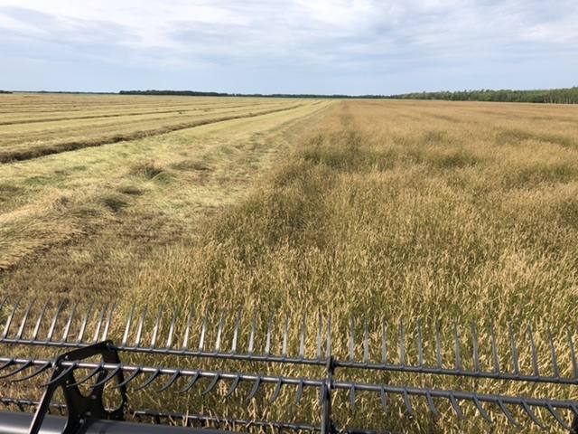

              Swathing Timothy 12 days later than last year.
              Much heavier crop than last year. Really impressed with the amount of water Timothy can grow and thrive in!
              With the amount of rain we had in May and June this field would have had huge drowned out areas if the normal field crops.
                  I throw some Timothy in with my hay blends. In the low areas that drowned out, the only thing growing there is Timothy. Exactly why I throw it in the mix. It can take flooding like almost nothing else except reed canary maybe.
