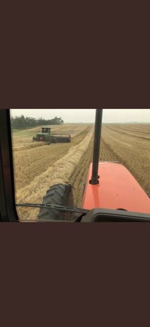

          If you can find a PT that is the same size as a SP that has auto steer you can team them up. The SP goes up and back then drop 2 passes. The PT goes up and back on the 2 dropped passes. Did this lots when we needed to knock something down fast. We were using 25 foot machines so 50 feet up and back and both swathers stayed together. Worked good with the kids.
