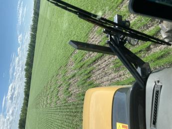

    this has been happening for 5 years since we got this new tank . Morris came out 2 years in a row and tore it all apart . could find nothing wrong .it does it mostly in canary seed , sometimes a little in oats. we are pulling it with an STX 440 , not real big volume hydraulics . we also put 3/4" couplers on tractor , fan hoses are 3/4" already .its a 55' maxim 2 drill with small wings (90") . thats the only place it does it is on those 2 wings? morris did put restrictors on the other pipes . so this year i ran fan a lot faster, opened seed dampener wide open and its the worst its ever been ? t never done it with the previous 8 series tank , same drill, same tractor ? the pipes have never plugged , nor do i see fan speed changing on monitor ?
    im baffled? anyone ever saw this before?

      Only thing I can think of if the fan is putting out is if there is a restriction in the manifold. It would likely have to be ahead f the distributor. Garbage of some sort or a build up of fert. Unless there is a build up just after the meter

          Have had all pipes off
          New manifolds and hoses

              thanks tom
              thats a lot of info
              but strange it only does it two outside wings?

                That is very funky. Never seen anything like that before

                  Can you switch air hoses at the cart to see if problem is at cart or on seed tool ?

                    Meter roll wore out on shaft?
