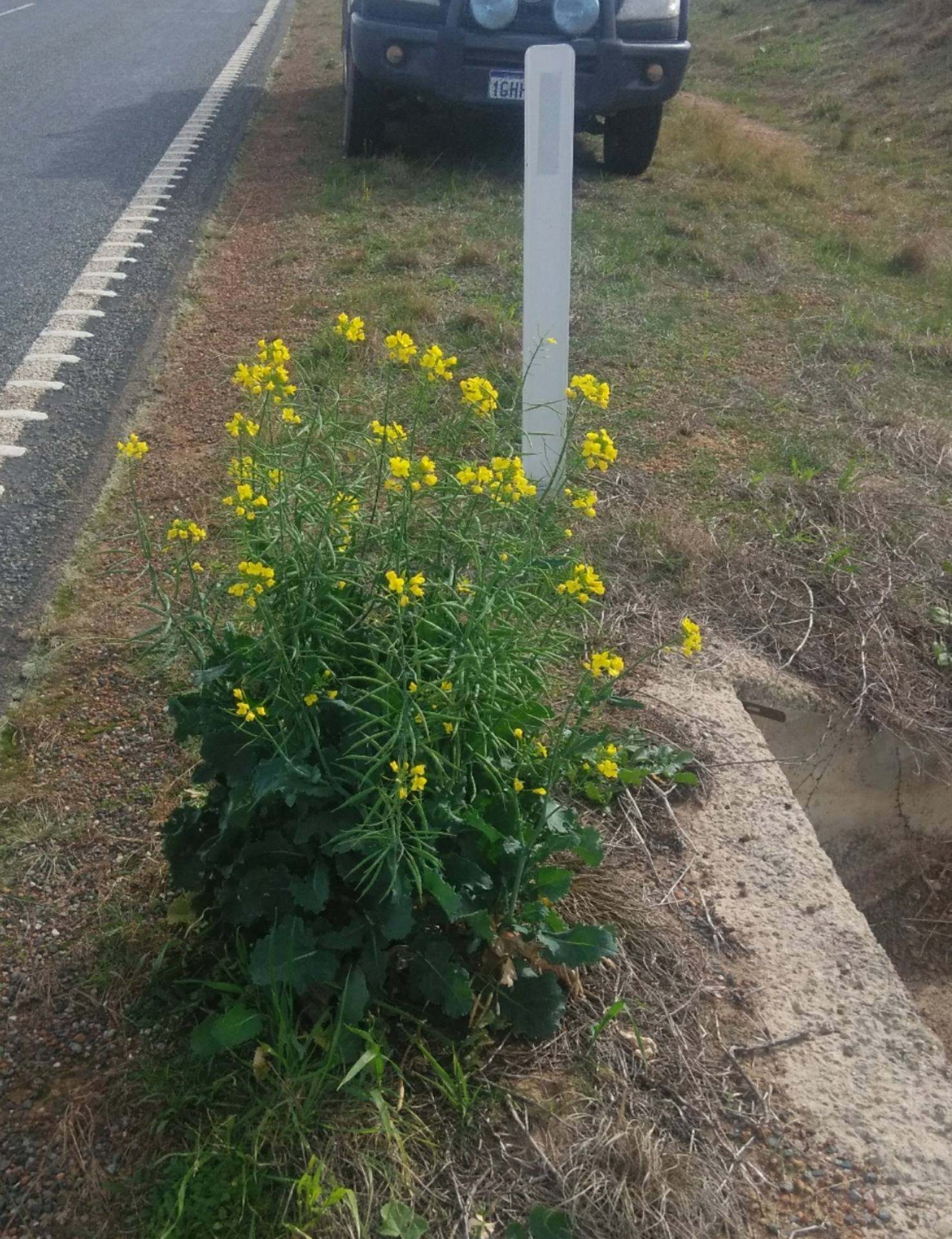

              You're obviously way ahead of the game with the planter. What do you make of this volunteer plant though. Pic taken mid June south coast near Esperance. No fert, no insecticide, no fungicide, no herbicides.

                  Oops forgot to attach this
                    Yup see that lots around bins , shops and sheds
                    But also out in the fields where individual plants have space to grow .
                    I have seen plants as big or even twice that size when scouting fields where a planter and or seeder has not turned on fast enough on headlands or in wet areas where other plants have drowned out but a few made er. Nothing most of us have not seen before .

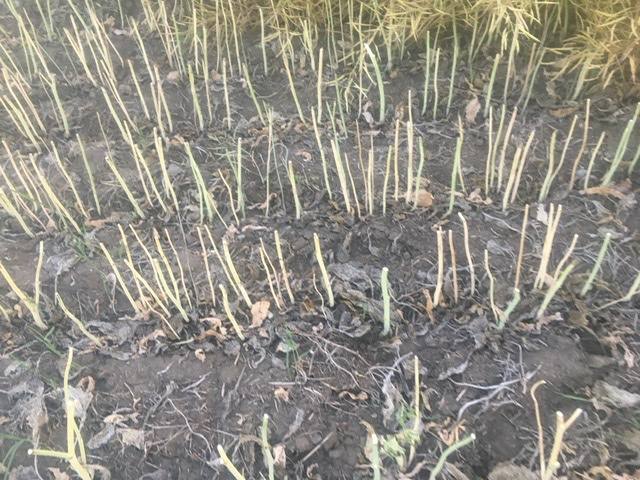

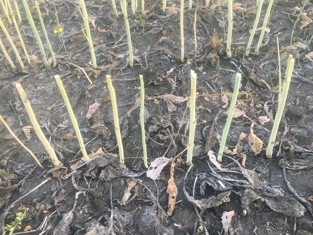

                      Here is an example of stubble from canola planted at 2 lbs and canola seeded at 5 lbs .. tells the same kinda story ..
                      5 lbs with seed drill
                      2 lbs with planter
                      What do you think the plants looked like during peak growing season ?
                      I know , I have seen the difference for over 5 years , every year . And also when using a planter and PP , fungicide use has been near zero . Healthier plants and air movement reduces plant disease dramatically. Disease starts with spindly plants the vast majority of the time . Why ? Because spindly plants have lower sugar levels right from the get go .
                      Seen this in peas seeded with planter as well , low areas that generally fall down from disease pressure are nearly non existent when planted on 15 in rows and 1.5 bus / ac rate . But that just common sense . Is it applicable on every farm in every climate zone .. probably not .
