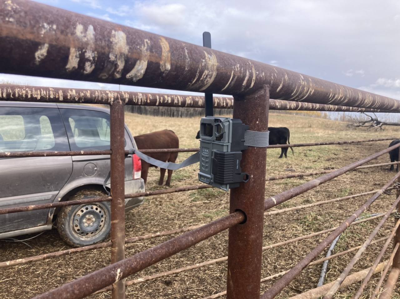

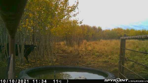

    Been thinking about how to monitor remote waterers since most of our pastures now rely on troughs and we fenced out the dugouts. It has definitely been an issue this year since most sloughs dried up which rarely happens here. Nothing pleasant about fixing a water issue with a couple hundred thirsty momma cows voicing their displeasure to you.
    Bought a couple of these cell based trail cams on sale and had a rain delay in finishing up combining so today I’m figuring them out. Only wish I could program them as to when to take a picture but I can only control when they’re on. I get 100 free pictures a month or can do a 1,000 for $10/month which is pretty reasonable.
    I can see this saving a pile of time next year and taking away the nagging thought in the back of my head saying I should spend the hour to check the troughs.

            Bullshead……… how do you keep the cows from messing up the pump if you don’t fence the water hole out? This year the charge controllers died in both our solar systems within days of each other. Otherwise they’ve been great and very reliable. Planning on moving one camera with each bunch as they move. Just have a mount at each waterer and strap it on.
