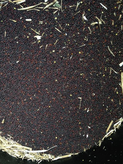

            • 4105
            We noticed dry burnt out areas by far worst
            Low areas with better yields there is very little , most varieties the same in this area
            Ran out a sample in 2 fields a few days ago, thought we were cracking the canola. On closer inspection it was indeed sprouted canola. Looking earlier in the year I had observed sprouted canola in the pods.

                      furrow I am seeing a tiny fraction of this sprouting in the canola. Maybe under 0.5%. Testing dry 6-8% moisture. Blowing it down before going into storage. This going to be a problem? What's safe threshold for sprouting? This is all new to me.
