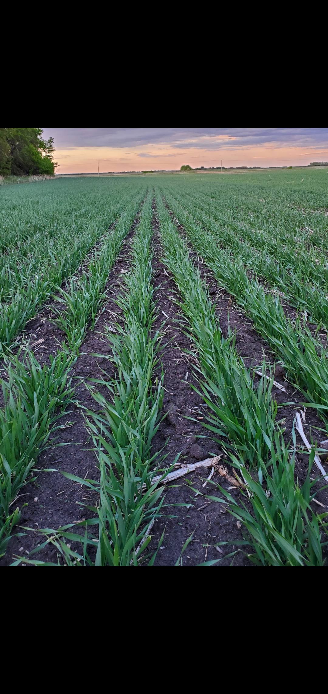

        setting up another drill for cereals is an option.. more junk in the yard is the down side.. the dutch openers do a great job but pull like anchors.. a narrow knife on 9-10 in spacing would do a smoother job then the dutch on 12".. but won't produce like the dutch
          Has anyone done yield comparisons?
          I think our bly looks better than any wide space/ narrow opener in this area.
