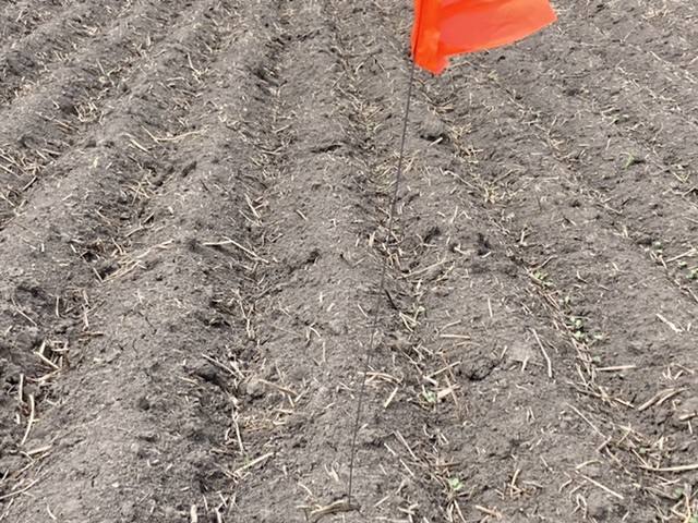

        Black seed row helps
        Furrow,
        You have minimal residue and a nice black furrow which seems to allow ground heat up to protect the canola seedlings. My straw covered seed rows freeze way worse than rows with some black color.
        What do you do to get it that black? Harrow few times and fall fertilize? Or do the planter residue managers keep it black?
        I use Bourgault 3320 qda drill and it seems the wheat straw flows in and completely covers the furrow.

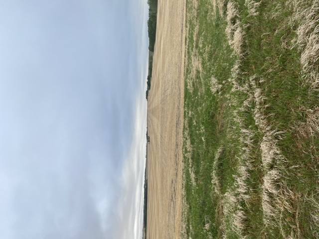

            90% of our canola now in standing wheat stubble
            That is direct seeded into barley
            The first picture from above was seeded first cause it was black bean stubble . Actually the very reason we seeded that first .
            I will get pictures of the canola in cereal stubble in same conditions later today . It is a bit thinner in very heavy trash areas but still ok .

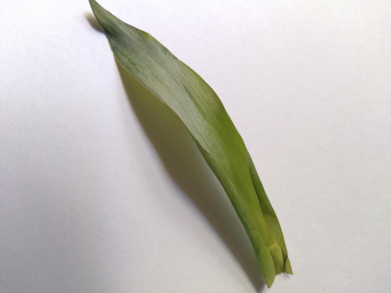

                    Corn leaves are nipped, but not frozen to the ground, in the area I walked. Didn't check the lowest ground though...
Name:	Corn nipped.jpg
