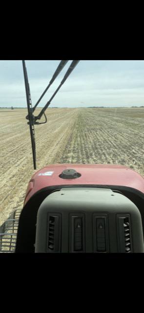

                      This is our 5 th year with the Horsch , still learning and trying new things .
                      This field had N floated last fall and then we deep banded 35 lbs P on the right .
                      Planter depth way more consistent in standing stubble , less frost damage on the banded side .
                      Way less weed competition on the standing stubble .
                      Establishment was way better on the standing stubble side due to soil moisture at seeding .
                      So at seeding time the standing stubble was preferred as dry as it was . By the end of May and 4 frosts the banded side had the edge but dried out . Now ??? We will see lol
                      Both are ok for establishment now
                      Same thing N application.
