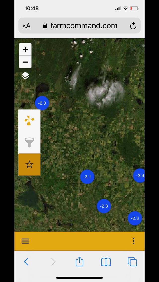

                    • 22575
                    That was at 10:48 pm just north of here
                    That’s Jackfish Lake on bottom left for reference.
