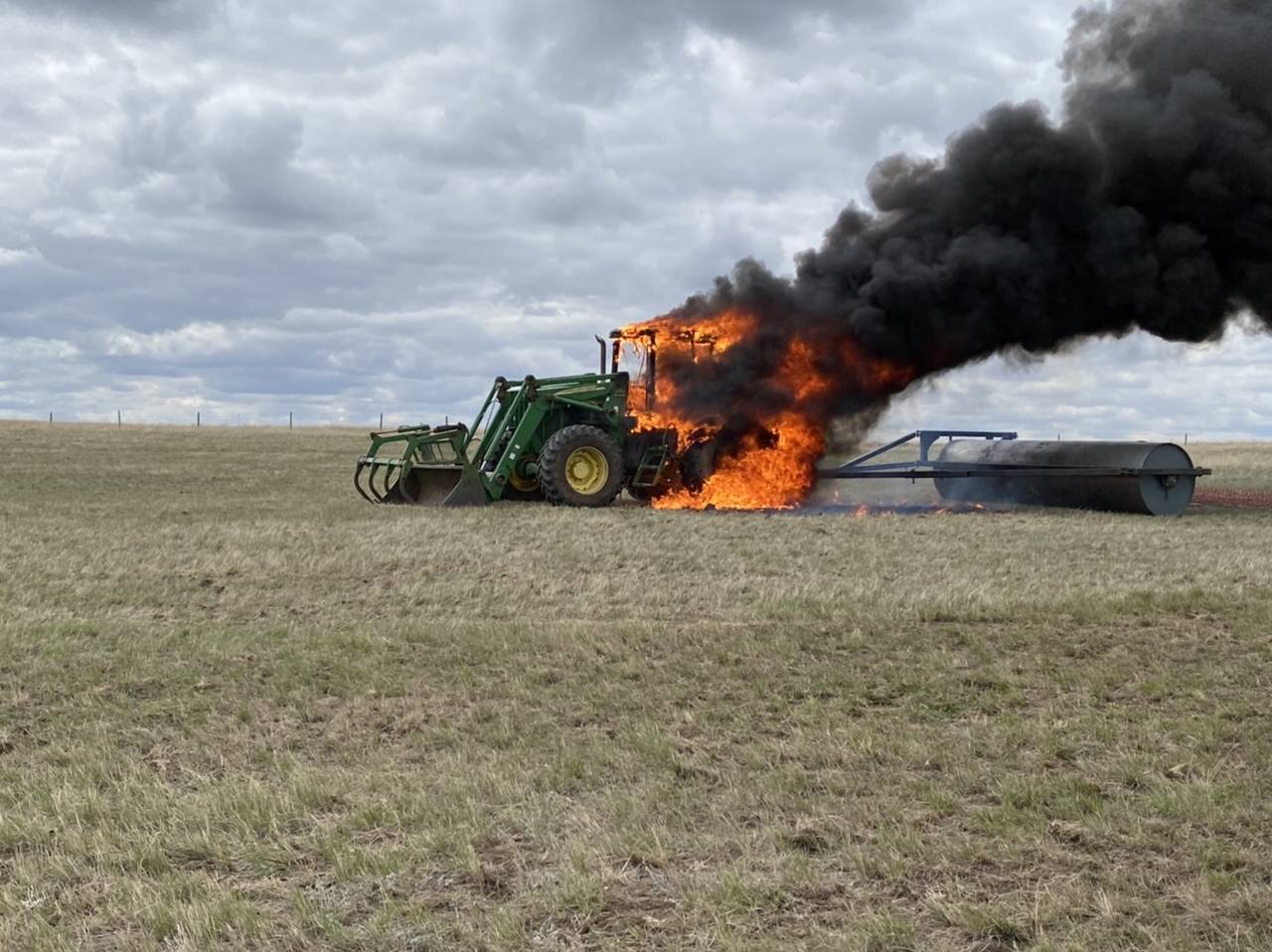

Update on tractor fire.
  • Happytrails
    • Dec 2009
    • 832
    The municipal fire chief looked at my tractor yesterday and thinks it was started by worn clamp on the battery cable to the starter. Such a minor thing with major consequences. Makes me think that a handy battery disconnect should be standard equipment.
