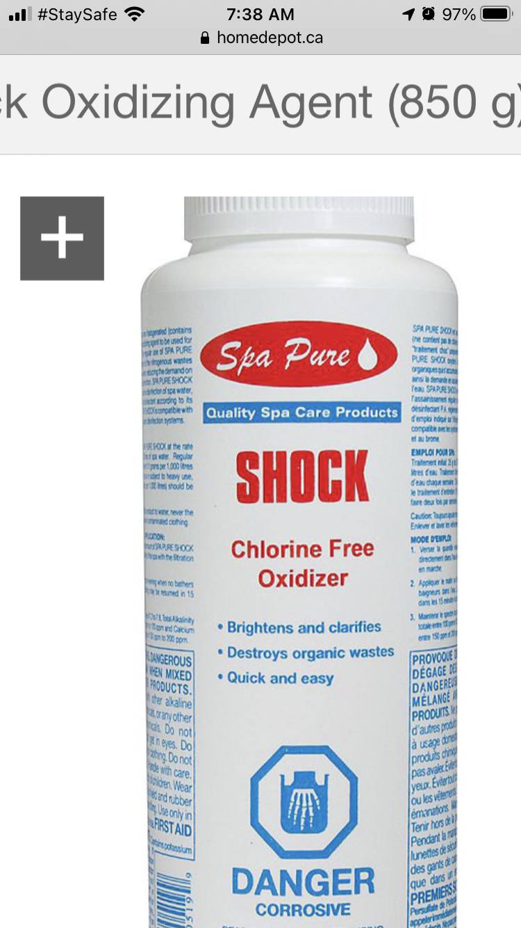

  • Ache4Acres
    • 816
    Try this it worked good for our well without the bleach smell. Had to use a fairly decent shot of it but been very good for a month now
