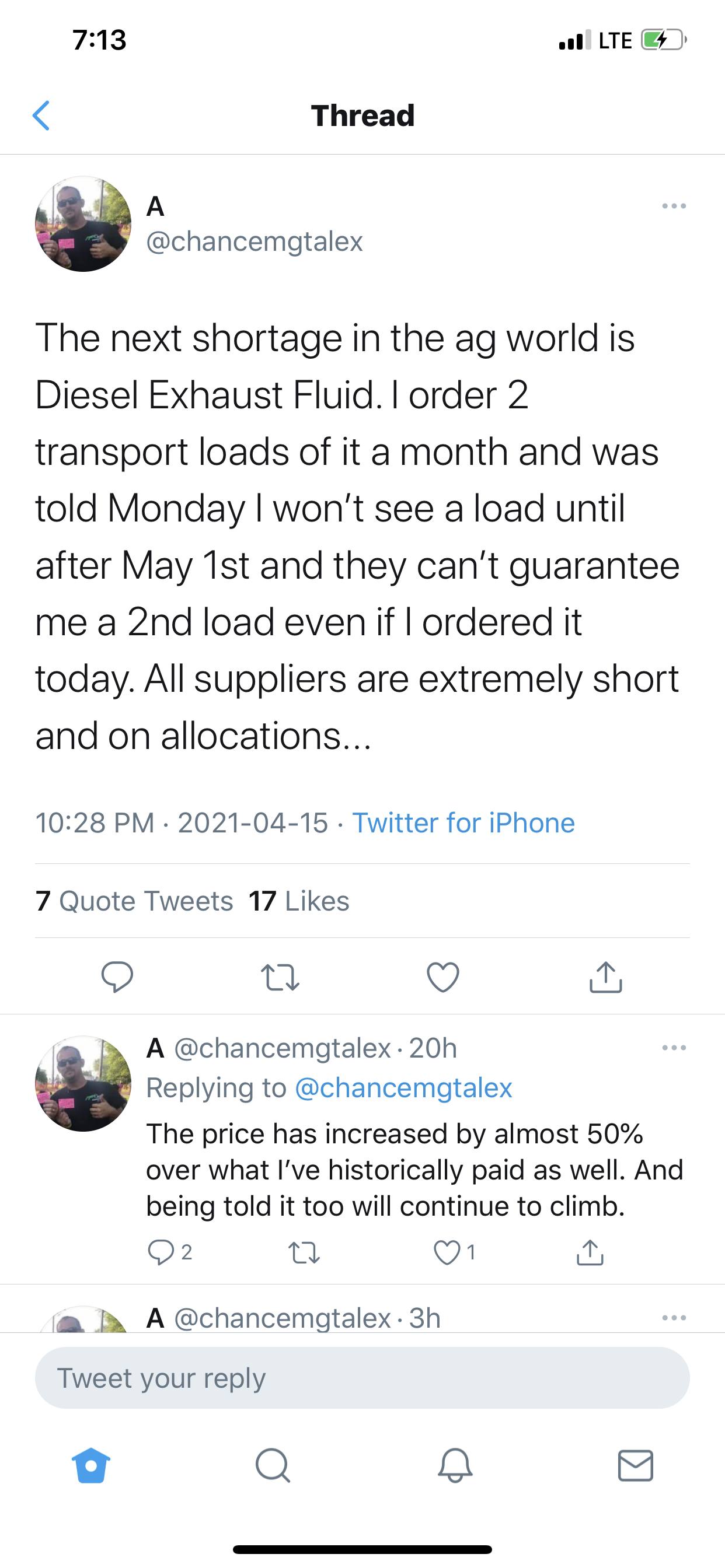

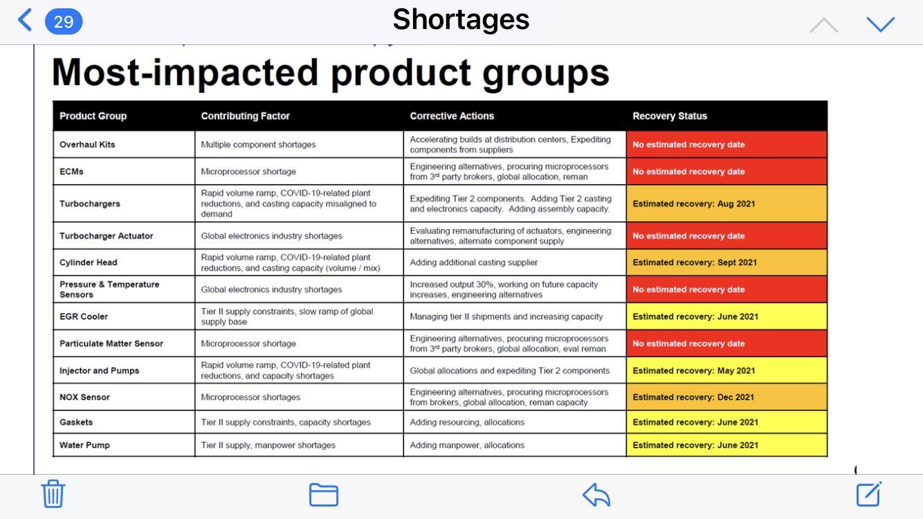

              List of Cummins engine parts availability problems:

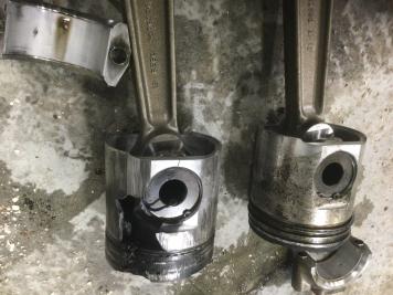

                    We had a semi go down just before seeding, started with excessive smoke coming out of the exhaust, pulled the Cummins N14 down to the injectors and found a broken tip on #2 cylinder. Run into Saskatoon to grab a injector, installed it. Started it up and was running smooth, stopped it and checked the oil only to find coolant in the oil and excessive blow by. Tore it down again to the pistons to find a huge gouge out of the liner in #2 cylinder where the injector tip decided to go. Phoned local rebuider to order overhaul kit, he phoned his supplier in Ontario and was told he would not know to next Friday if he had a kit coming and wouldn't gaurentee anything until he phisically had it. I did find a supplier who could have me a kit by next week.
