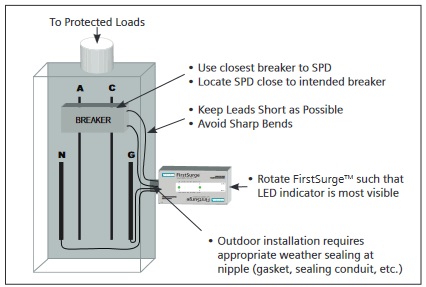

    Not sure about whole yard but one of these can protect your whole house, so a guy could put one at each breaker box where there are sensitive electronics.

                  Oh. I just referenced a known name surge protector billed as whole house with lightning protection.
                  They are sacrificial and will need to be replaced after they are worn out.
                  Siemens FS140 is the brand. there are other kinds of varying capacity.
                  Here is a pic of the specs:
                  Typical installation:
