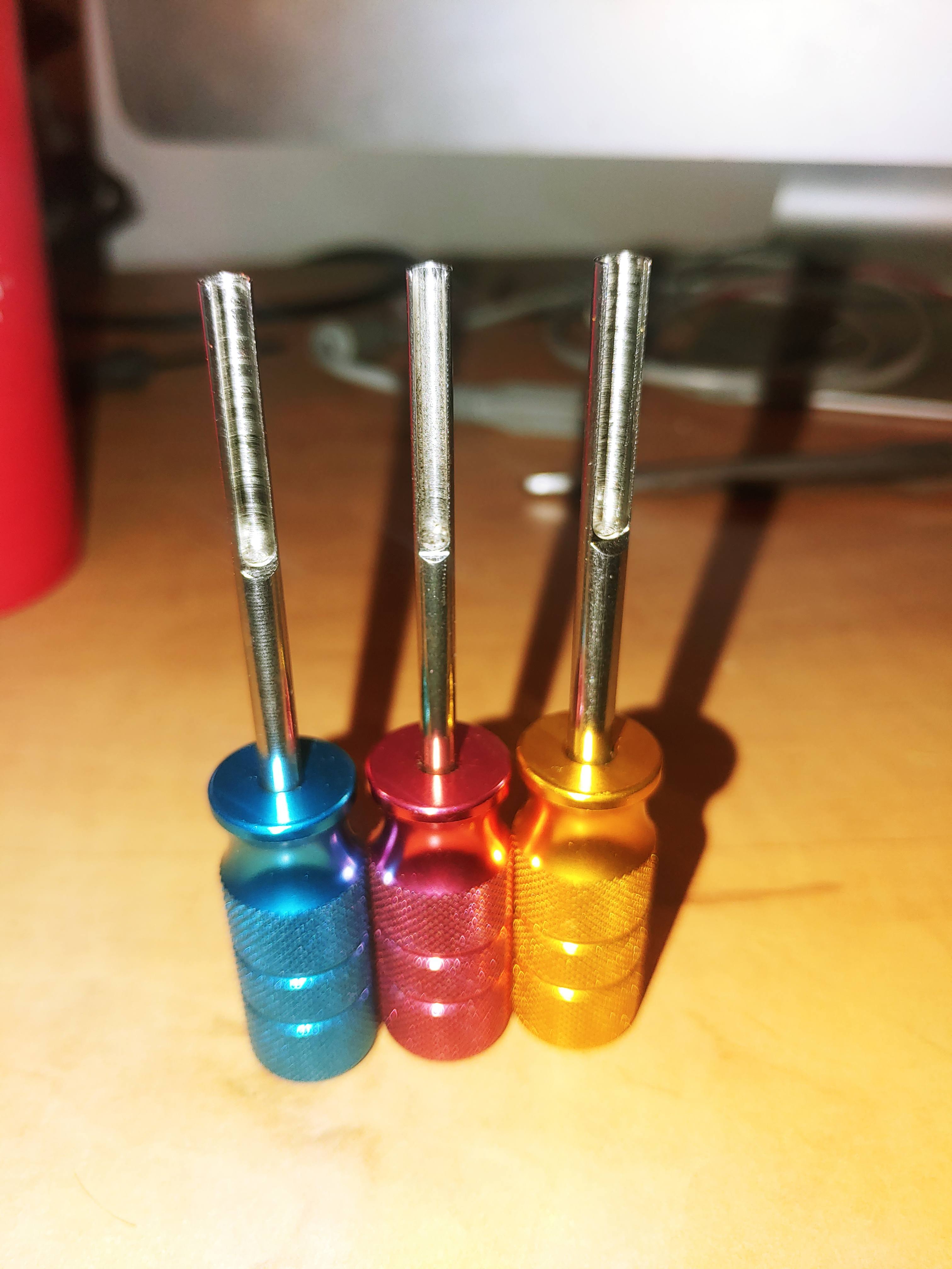

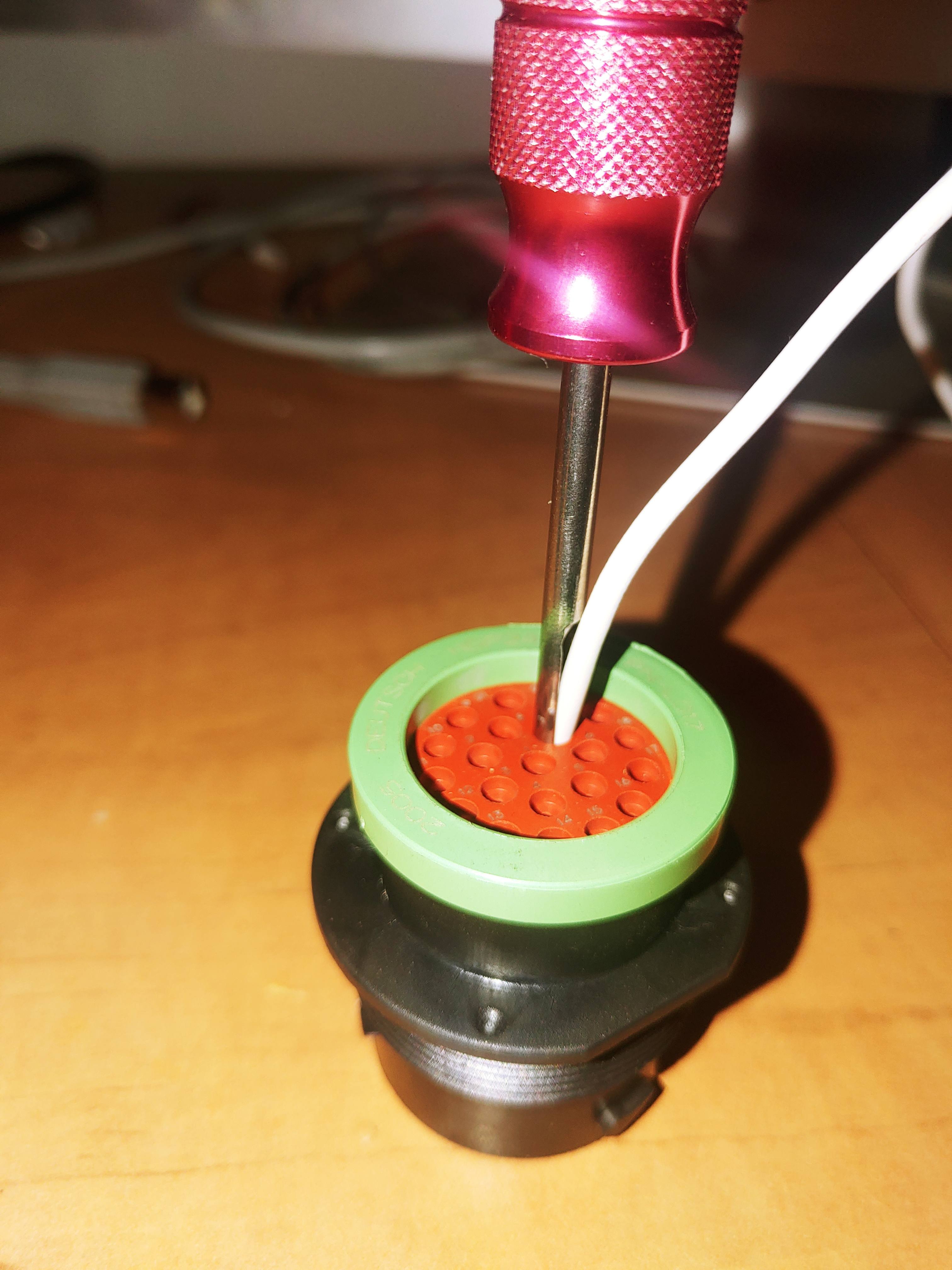

    To remove a pin, these are the proper tools. They are color coded to wire gauge just like crimp ends.
    To remove a pin, insert the tool straight in from the back, around the wire. Push till it stops. Then pull back on BOTH the wire and the tool at the same time.
    If it doesn't come out, pull the tool out, turn it slightly and try the procedure again.

      Thanks Klause. I’ve gone a few rounds with those before. Like most jobs much easier with the right tools

        Bought a used FC 1720 cart from a large dealer this spring. Three monitor boxes. Well which one came from this cart|? Not the one I got. Took a while to figure out that the pins were in different positions but I did figure it out eventually. The cheap plastic tools for switching the pins are useless. Need the ones Klause pictured which a local repair shop had. Problem solved and the cart worked good for a 27 yr old unit.
