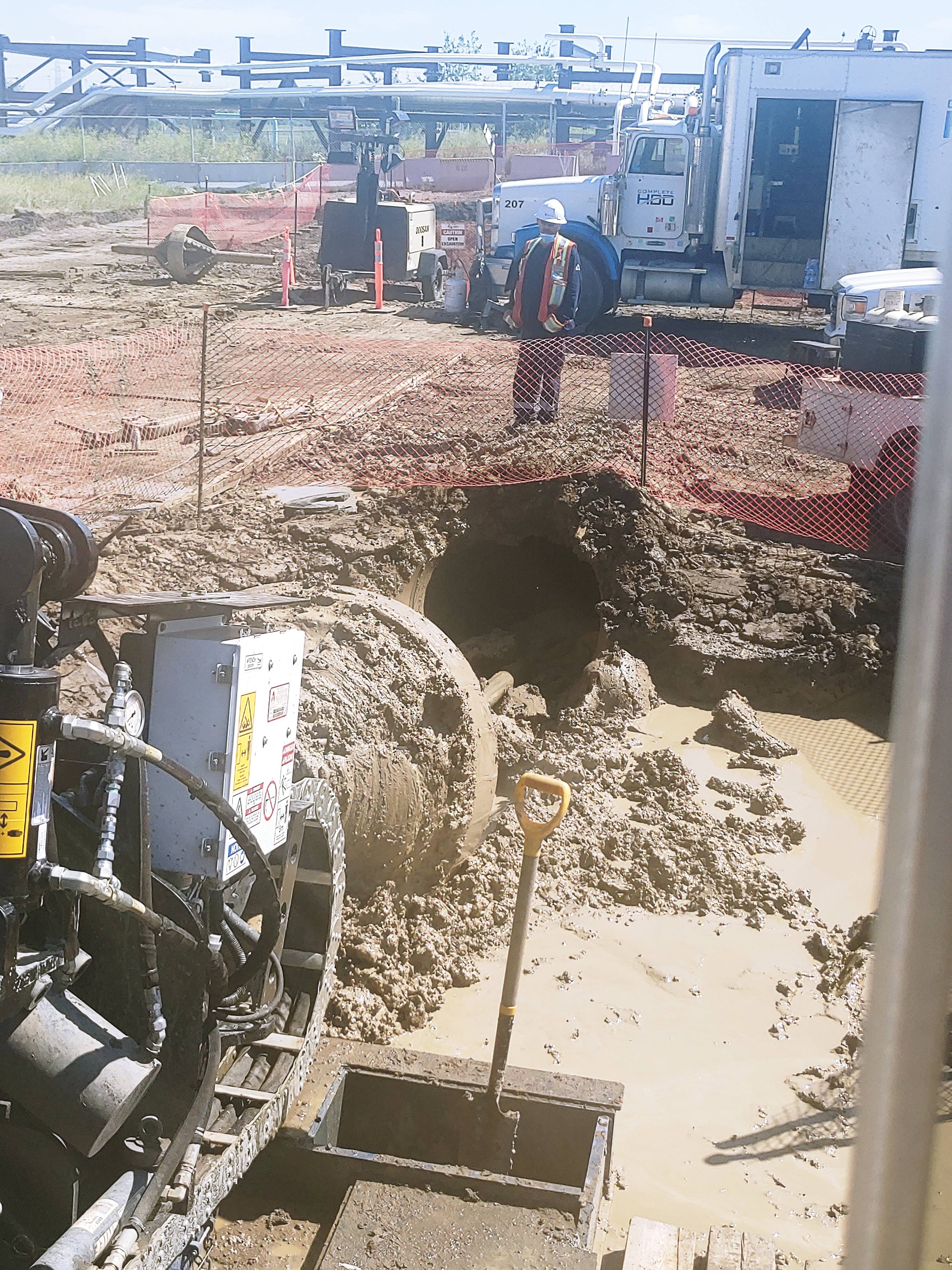

    This is a brand-new American Augers 240. Biggest rig built with on board mud pump. Automatic rod loader. Wireless telematics.
    It's safe, fast, quiet, and costs only a little more than a new 8800 lexion.

    Last bore I did before harvest. 554m long. 48" diameter 11 meters deep.

          Typically, do they pull or push the pipe through after the boring is done and what would be the maximum distance for boring underground.
              Pull. Because the forces are in your favour, as you pull the pipe in, the drill is being pulled towards the ground. There's a swivel attached to the end of the reamer, and we pull the product in after the hole is completed.
              It takes a bit of force sometimes to pull a pipe in. This drill can exert a direct line pull of 240,000 lbs. The biggest rigs are 2 million lbs. That pipe pulled in at about 75,000 if I remember right... That's more pull than a D10 dozer can muster.
              Bores are getting crazier. They've done 5 km by drilling from each end and intersecting underground. Typically we stay under a km. 500-800m is typical. 800m is a quarter section' worth.
              Nowadays, in sensitive areas whole pipelines are bored. Just dig a connection pit every kilometre or so, and drill again. Never disturb a tree, fish, frog, or shrub.
