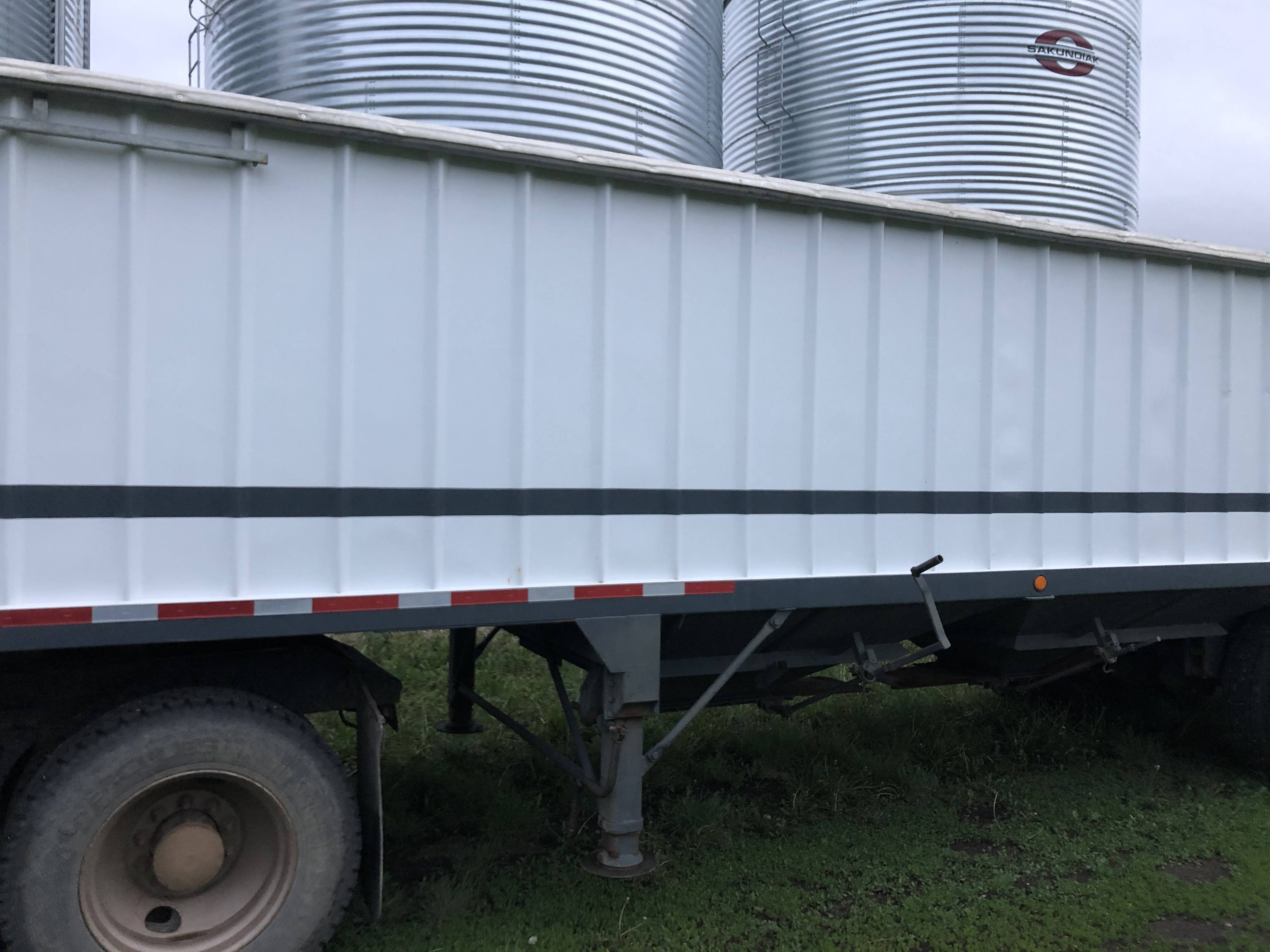

            This is a 1994 doepker grain trailer that was all rusty and I had it repainted by Jackson Sandblasting and painting in Saskatoon and I think that cost me 4000. That was in 2002 and it Is still rust free. I have used it right up until last year and still use it at seeding and harvest. The guy that runs that place told me the trick to make them last is just as simple and cheap as a few more mm of paint so the stone chips don’t make it to metal. Very happy with the job he did!

              I think I will just bite the bullet and blast and paint, is cheaper than new and as long as it preserves the metal I am happy. As it is now I can’t even get new conspicuity tape to stick.
