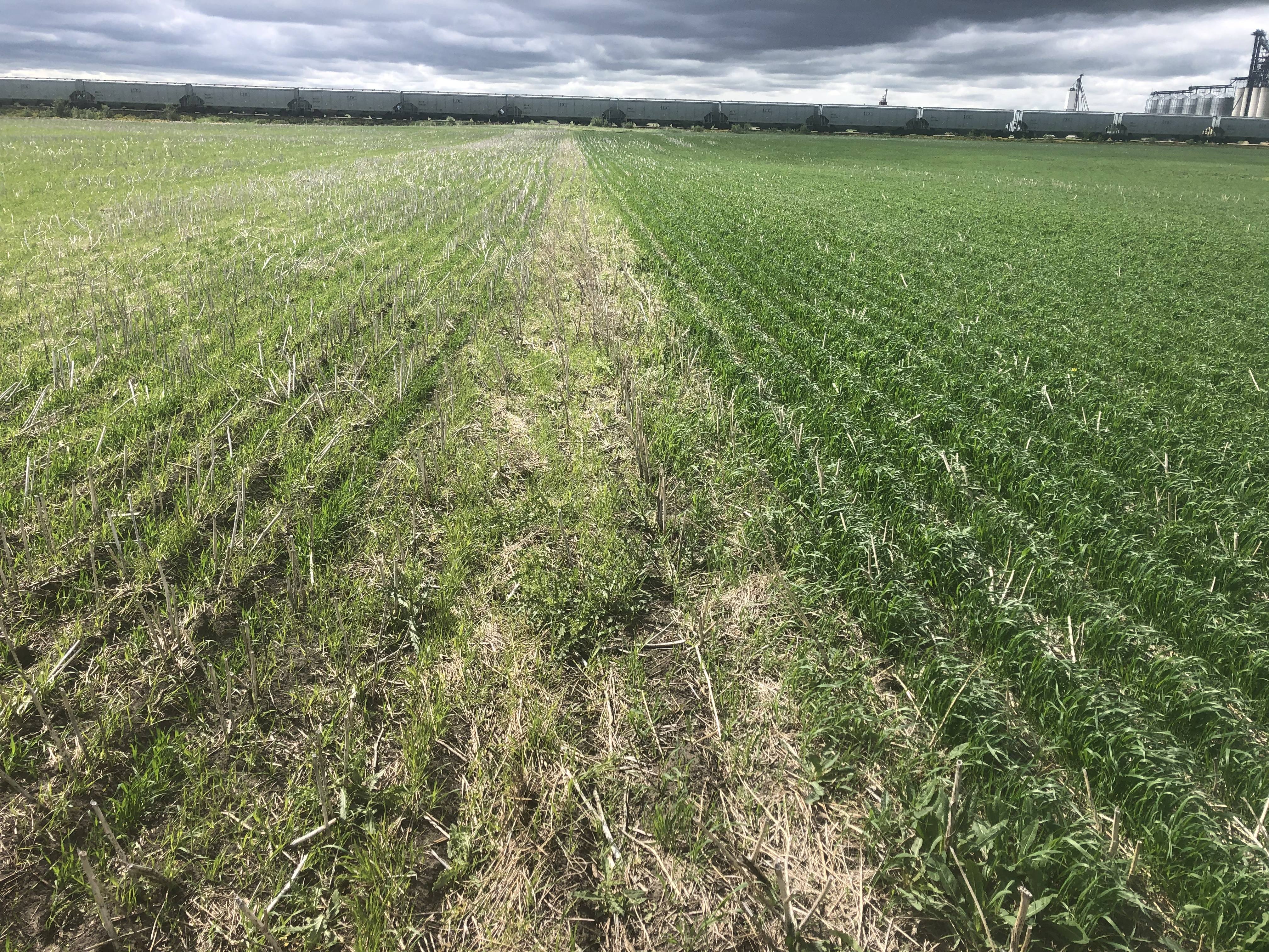

    Here is a picture from a few days ago
    Side by side , wheat sprayed same day ....
    Group 2 grass herb on left , Group 1on right
    Wheat on right only seeded one day ahead of left.
    Both sprayed within an hour of each other
    Was plus 3 that Monday morning.
    These were sprayed on Tues
    “It will recover” ...... yup standard answer

        Furrow very interesting picture. I have to be honest I would have thought the greatest risk of crop damage would be from Puma, never had an issue with a group 2 wild oat herbicide on wheat except when Varro did a poor job on the wild oats, ams helps but still not as good as Simplicity.

          I have been using simplicity and octane XL for many years and I have yet to see any damage like that. I even double sprayed the headland one time by accident and it recovered pretty well. But I dont spray in single digit temps either.
              I don’t know anyone other than one local custom sprayer that does much if any spraying in single digits . Especially in crop .
              We waited a day and a half after that plus 3 for that reason
              Point is , both were sprayed within an hour of each other
              We used 7.5 gal water , neighbour used 5
              It will recover but we lost a good 7-8 days maturity. Not ideal in years like this

                Was the Simplicity a tank mix or alone with Agral? High rate?
                  • 22657
                  Tank mix , low rate
                  Weed control is very good , just surprised at how much yellowing
                  Lesson learned, leave an extra day with products like that in cool weather
