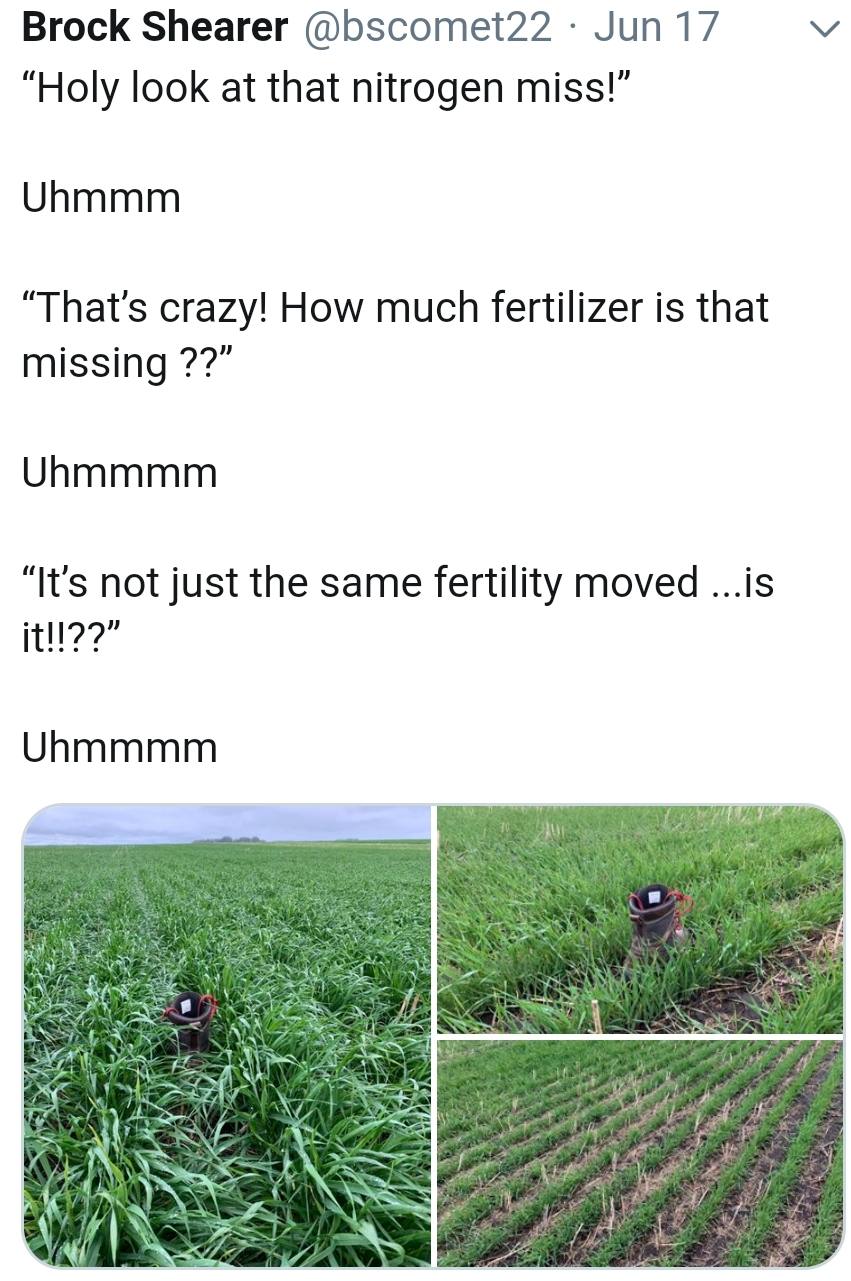

                  You want to see interesting stuff on fert placement? Follow this guy, he's a great salesman of his consulting, but he's seen enough to know. I don't use him but the pics he posts are startling
