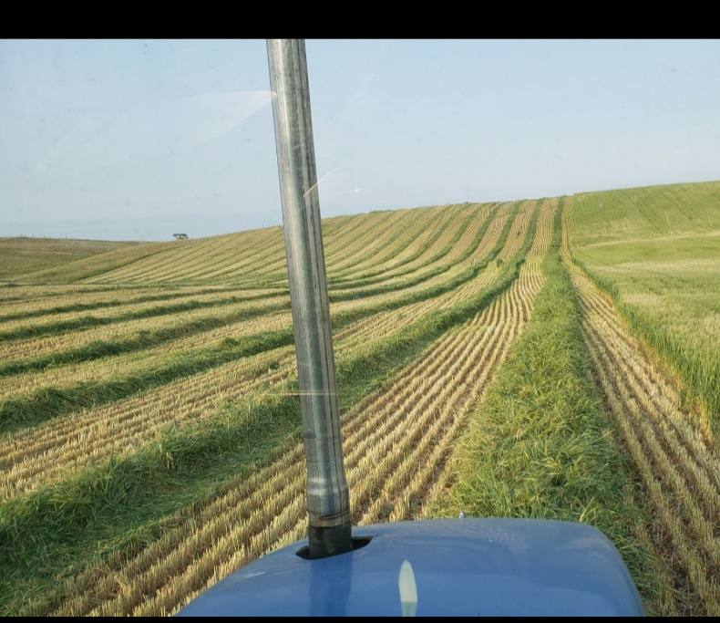

            Do all cereal forage as yellowfeed. Works well for us. Dry down times vary substantially with weather conditions. Could be as short as 14 days or as long as 28 days.
