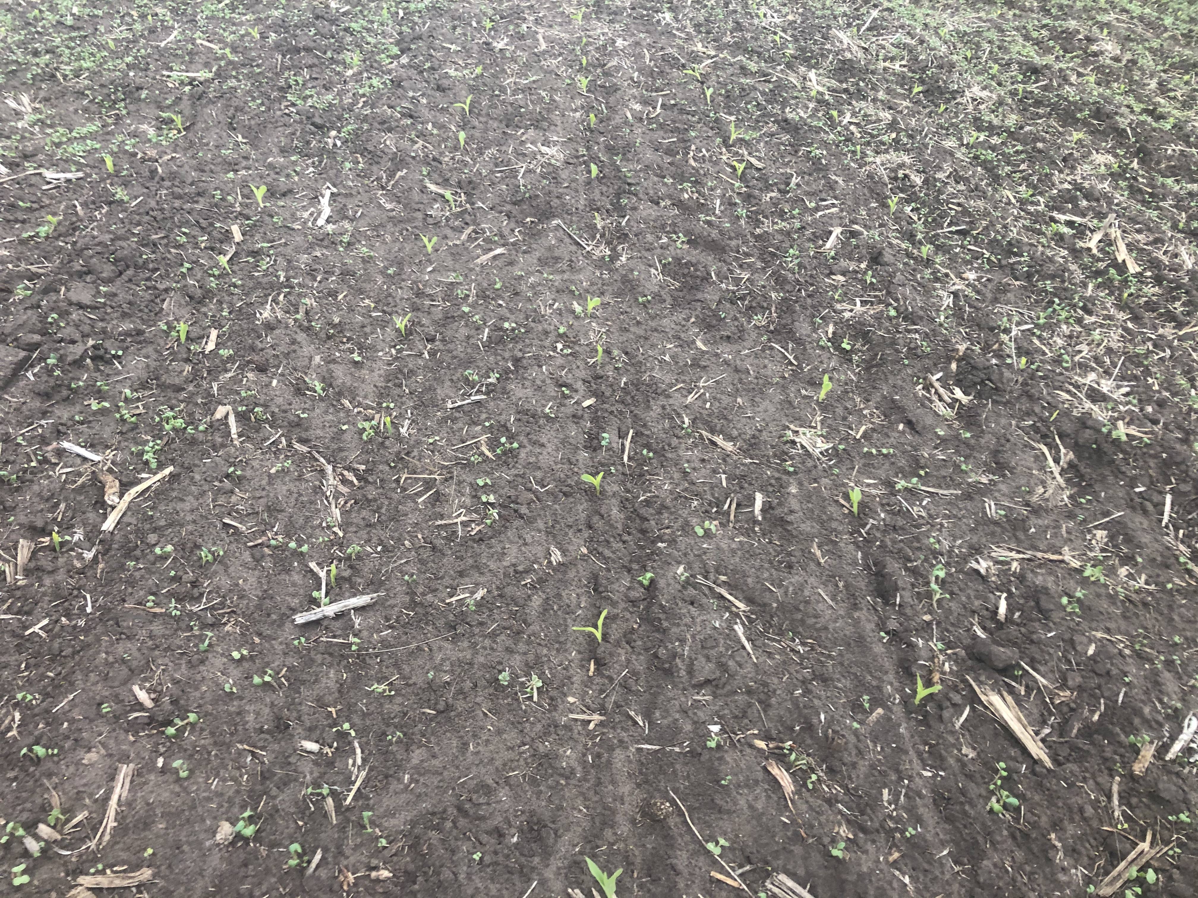

    Did some corn at 15 in space
    Same 32,000 seeds per /ac rate as 30 in
    Seeds roughly 10 in apart compared to 5
    Tried to offset every second run 1/2 second to utilize space .
    More research showing benefits to this the farther north you go
    Should utilize more sunlight and be better for crop competition......
