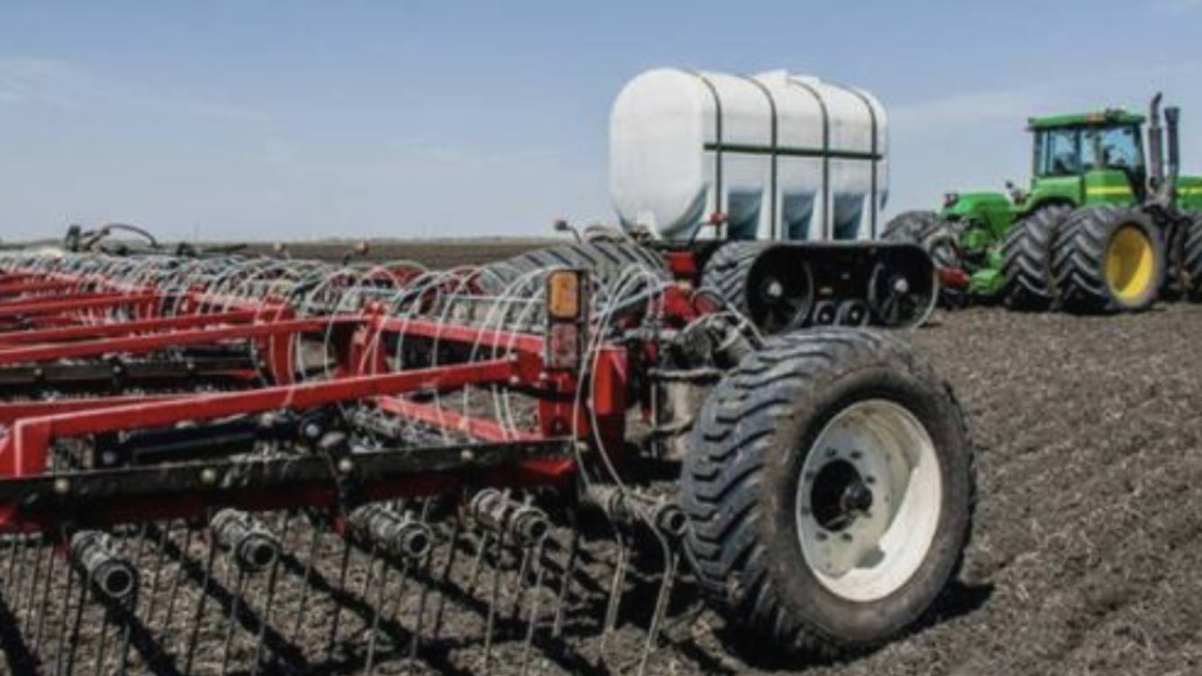

                  We are going to set up something similar to this ...
                  We were going to do it last fall but the weather left us no time .
                  Contain N is a very reasonable cost for a stabilizer
