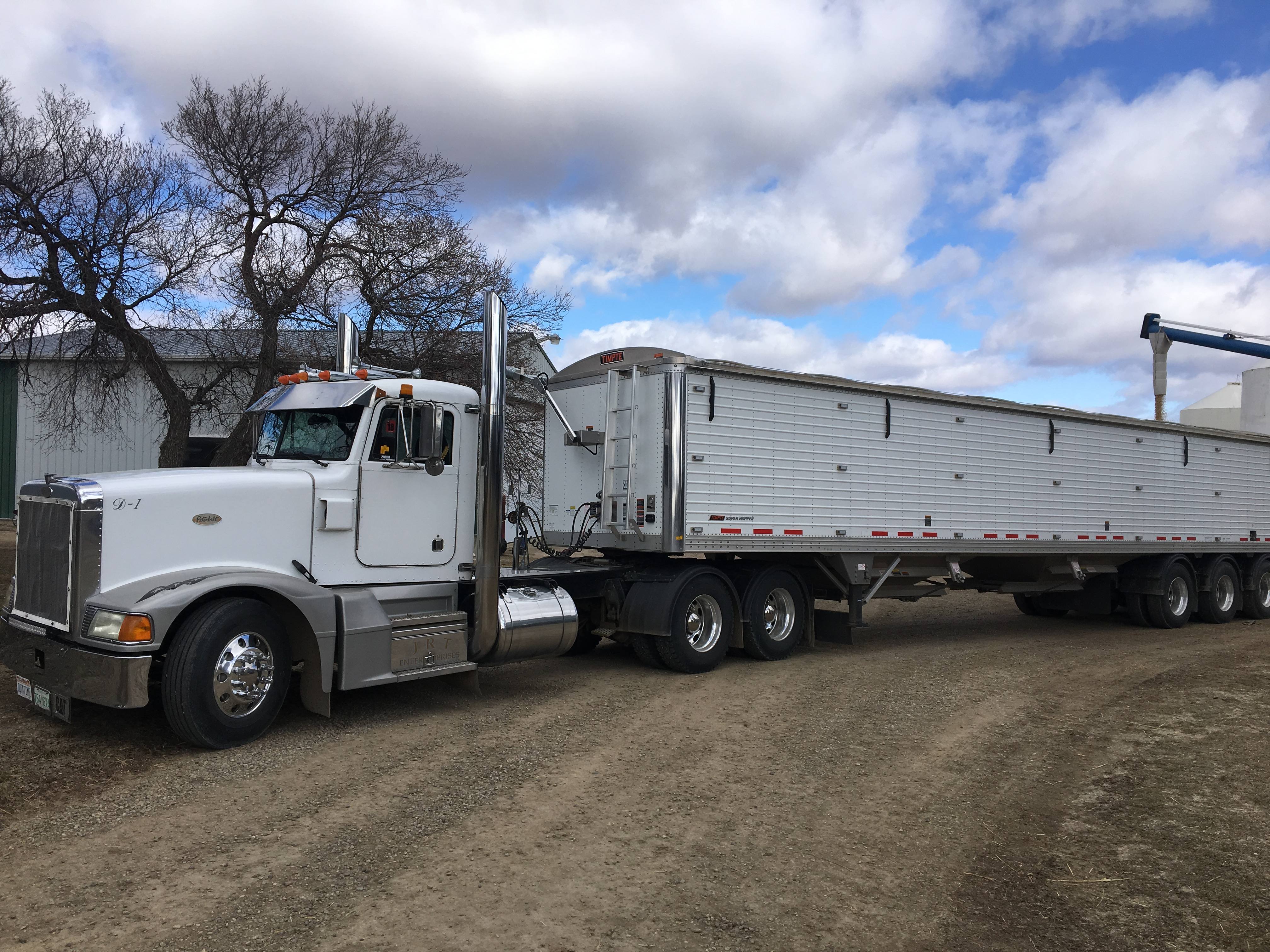

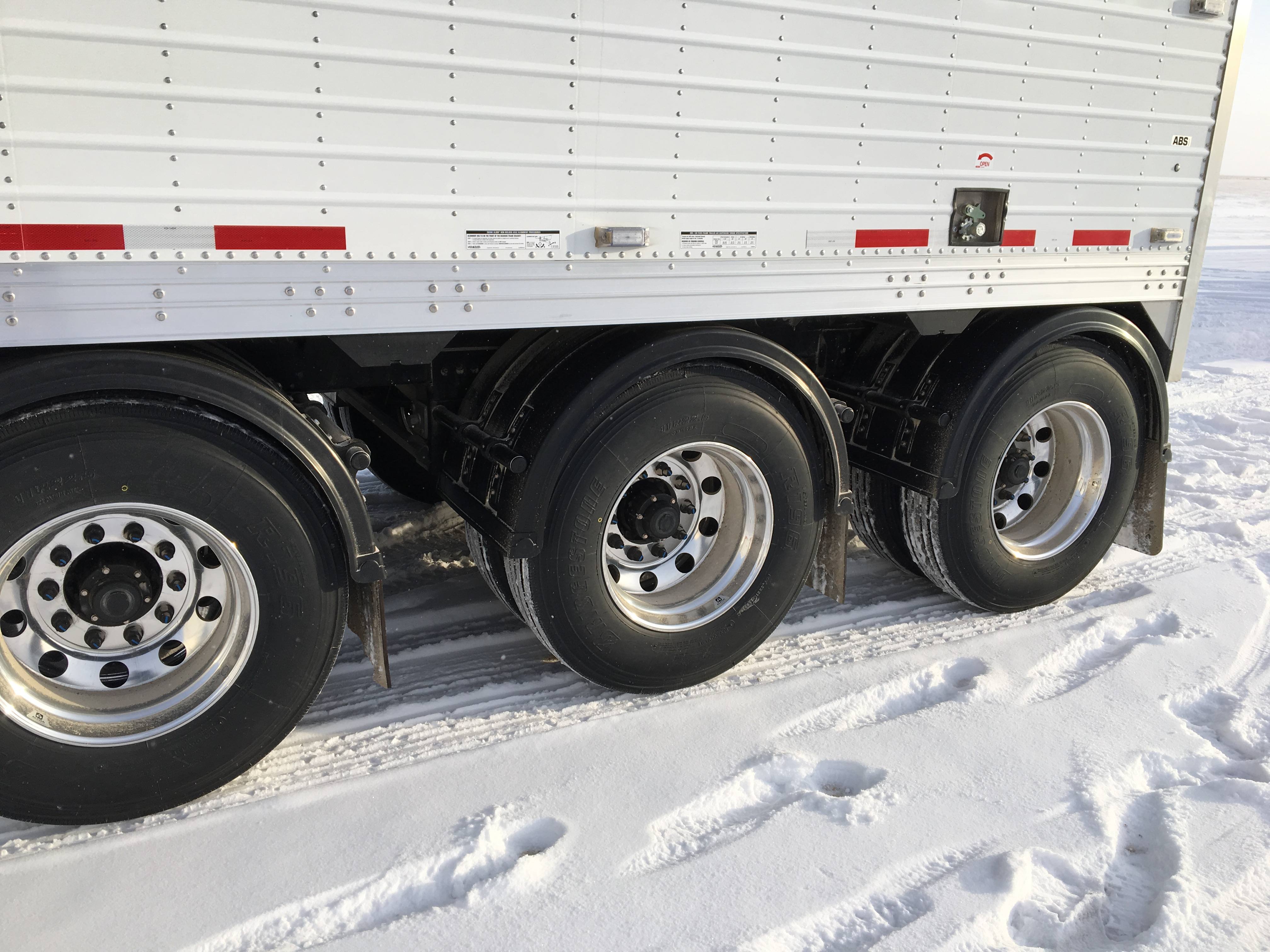

                Poly. Fleet Engineers would be my first choice. We've had trailers with both poly and stainless, and I'd choose poly.
                  • 17504
                  Looks BRAND new, unless you like polishing aluminum.

                    In that pic, yes. Durabrite rims still look that shiny after 2+ years.
                    Will add to my other post. Have Minimizer fenders on 3 trucks and one trailer that was sold. Not a bad choice, but impressed with the mounting brackets, price and quality of the Fleet Engineers.
