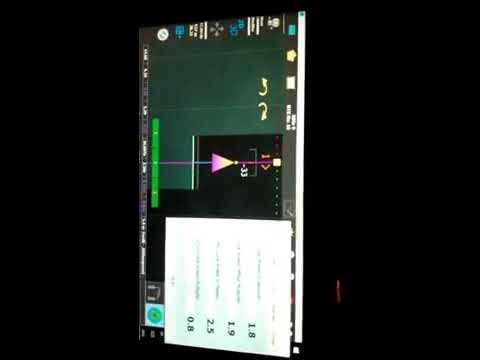

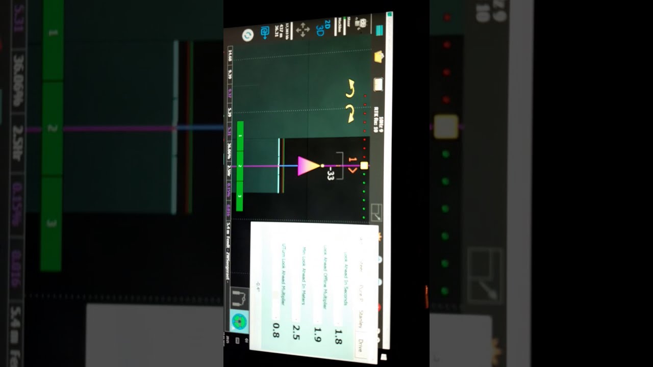

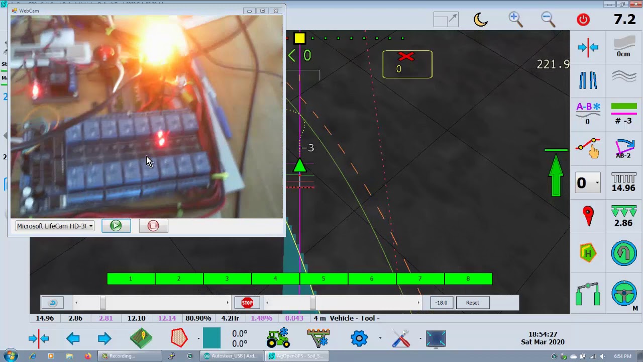

            Latest video shows a quick example of the capability of the new version. Up to 16 channels of turn and speed compensated section control, automatic and manually manipulated headland lines that works with section control, implement lift, and full configurable turn around that can be from no skips to as many skips you want for "zebra" pattern. there is also tramline generation, touchscreen guidance line making - so many cool things.
            Around the world people are working on second GPS on implement for implement steering, full multi channel rate control, camera guidance, weed id, small robot ideas, robotic weeding, all open source and shared.
            International video conference today about deciding the best strategy for a machine control system that works with autosteer to be universal enough to just have simple autosteer or up to full machine/hydraulics/guidance control.

              Planting onions at 4 kmh, Dead on!! At most 1 or 2 cm off.
              Der Offline-Wert in Zentimetern geht nie über 1 oder 2 hinaus und pflanzt Zwiebeln.

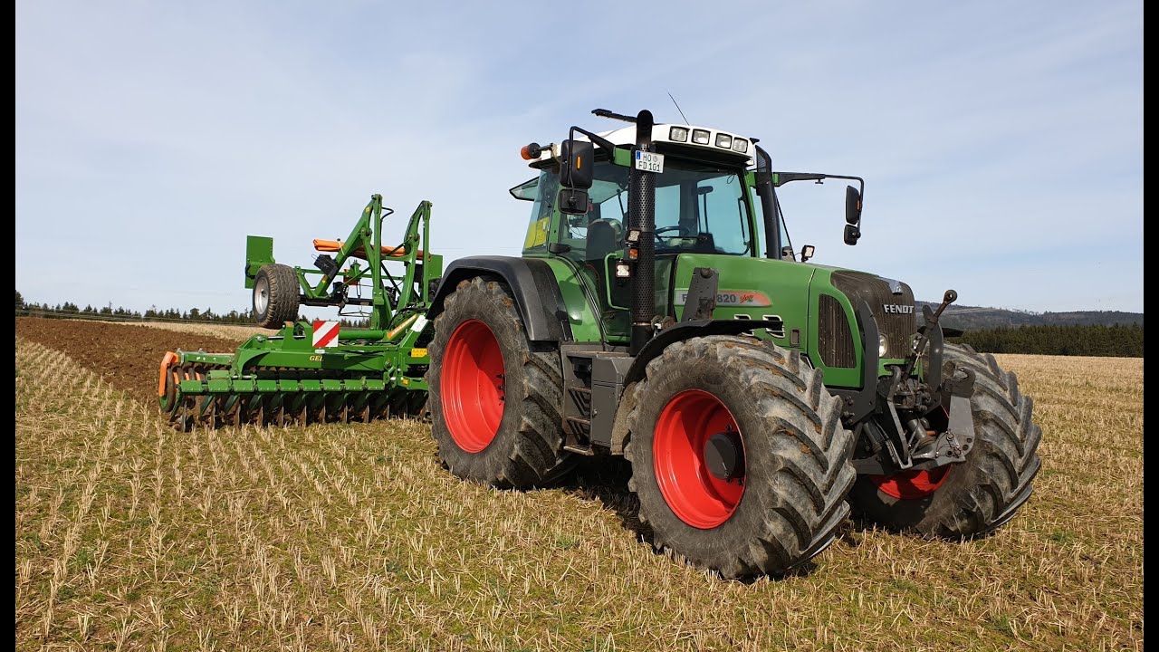

                Thomas from Germany using the full machine control, uturn, completely hands free. Movie time till the field is done.

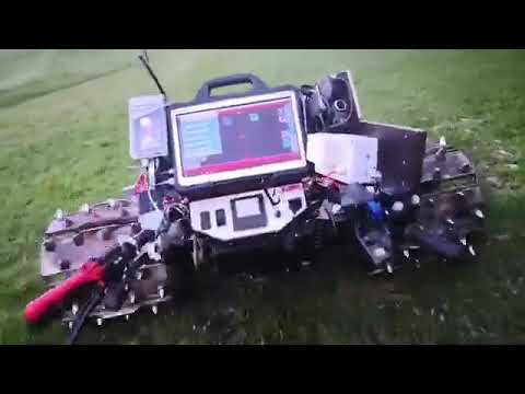

                  Better video showing AgOpenGPS running the mower in the Alps.

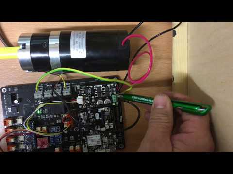

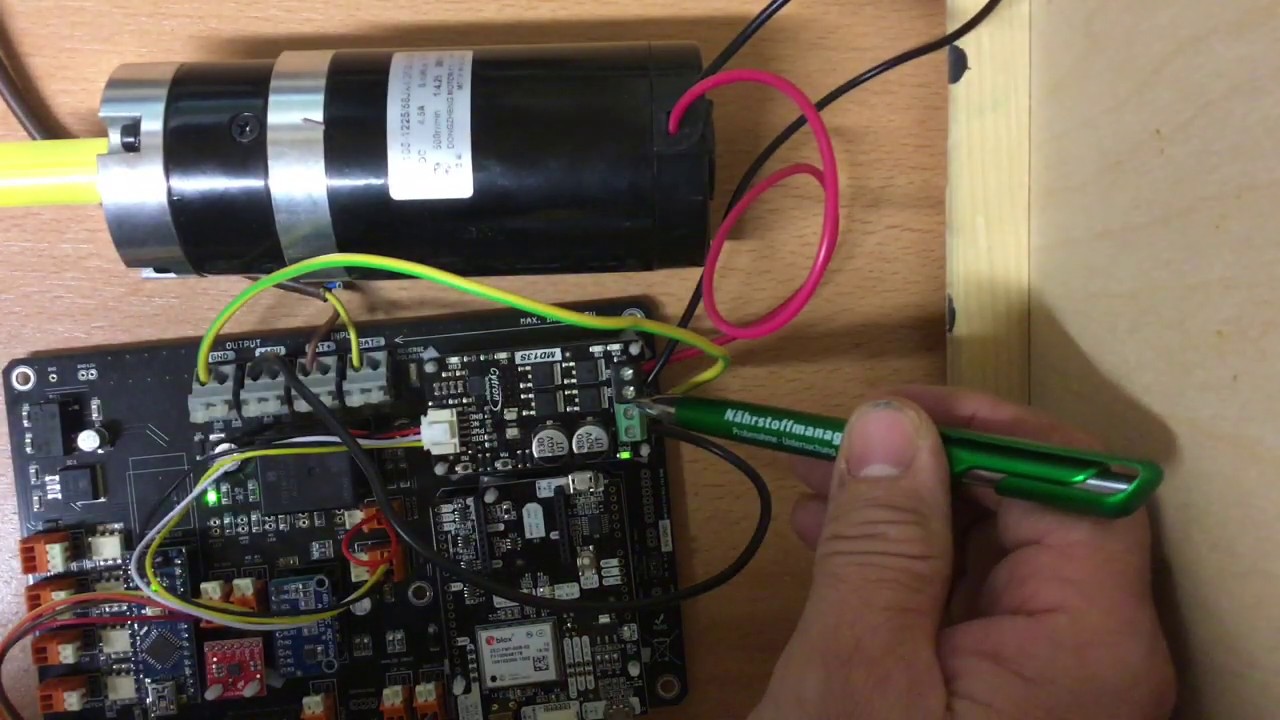

                    How to build autosteer AND get around insane Euro regs on electronic parts.
