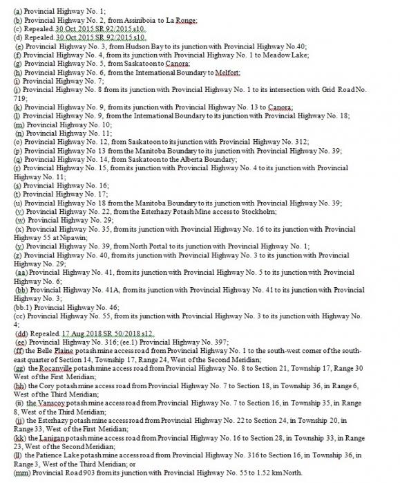

    Can someone help me regarding which highways are 63,500kg vs 62,500kg, I am having trouble understanding what is being called Primary.

        63,500 KG highways or portions of:
          • 3959
          There could be an exception, so double check the list but I think all seasonal primary weight designated roads (9 month) are max 62,500 during primary season and back off to secondary weights for the 3 month spring period which runs from either March 15-June 15 or April 1-June 30
            • 3959
            Also, weight restriction orders must be observed.
            The 15 km rule is not applicable during weight restriction season.
            Also where the 15 km rule is applicable maximum weight is 62,500 even if the destination is on a 63,500 road
            Make sure this is right for your own satisfaction. Not responsible for any tickets
