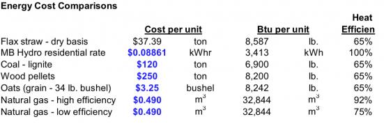

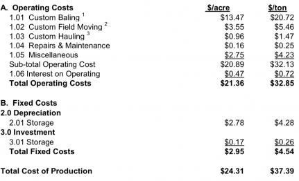

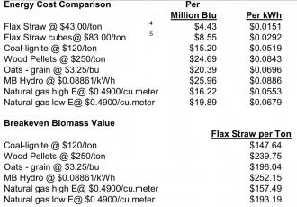

              We are part of this study in Manitoba, I just posted some excerpts...
              This is on flax straw. Assuming 0.62 metric tonne per acre yield.

                    At a cost of $0.0453/kwh, you could pay the producer $80/acre for the straw to recover nutrients...
