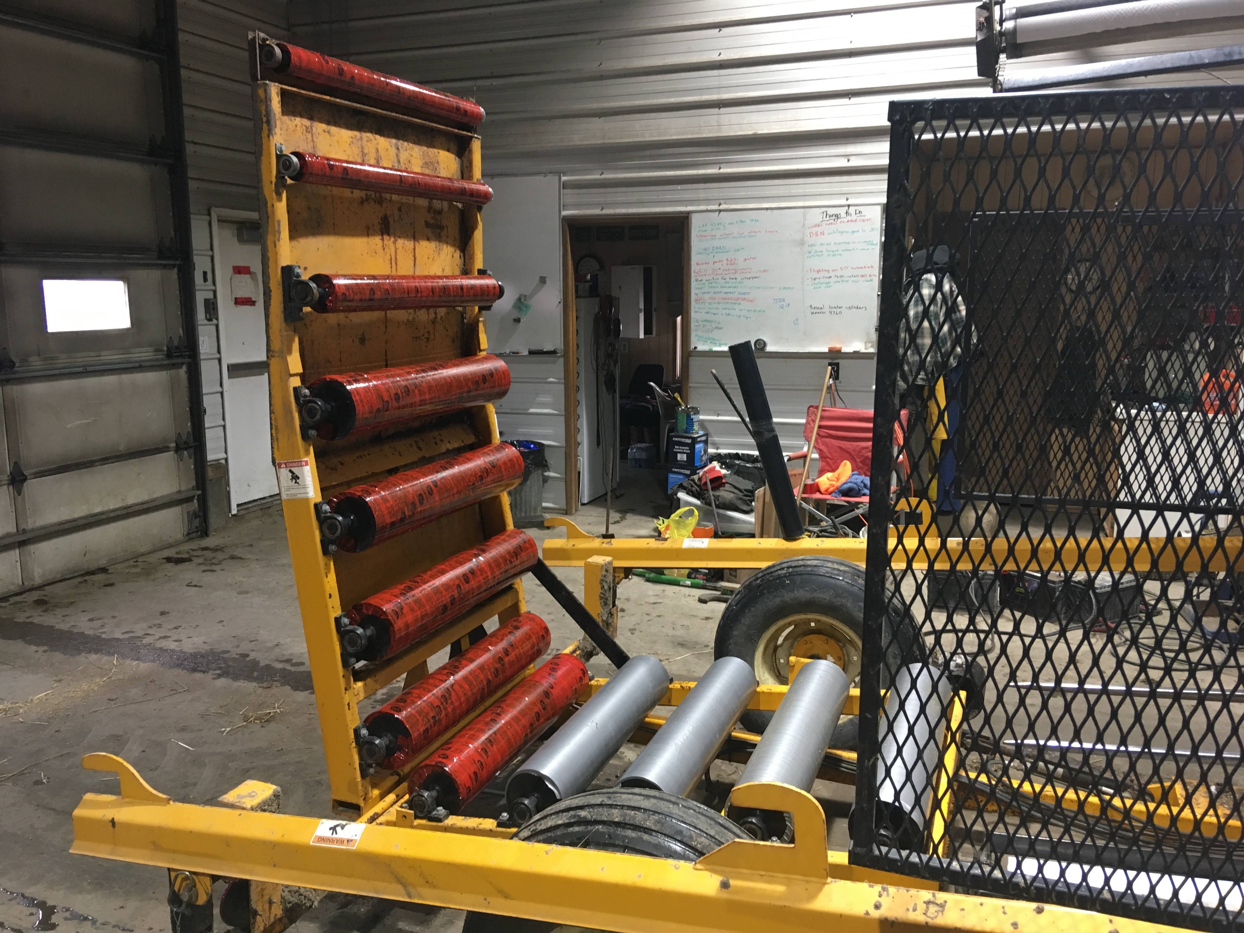

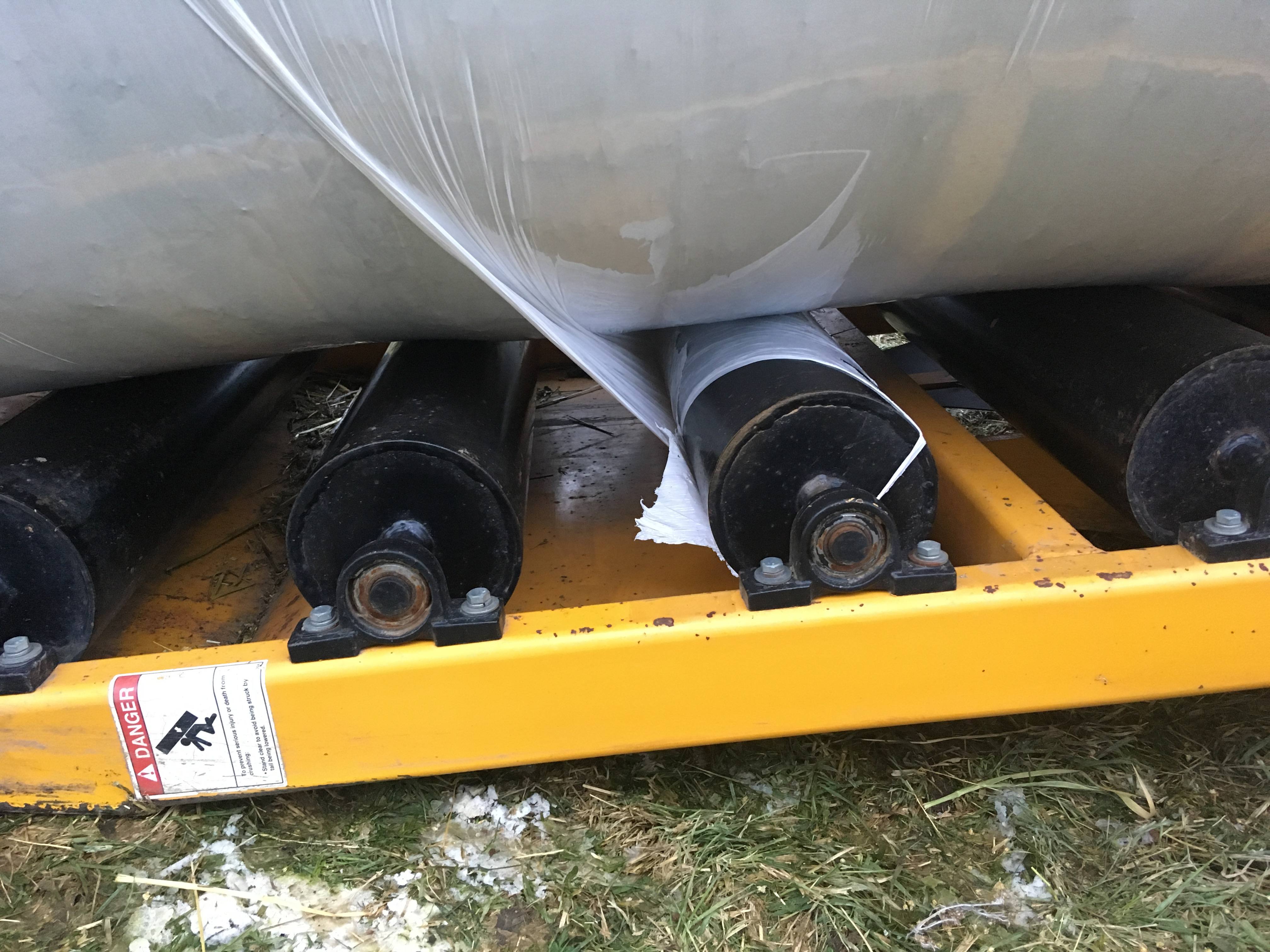

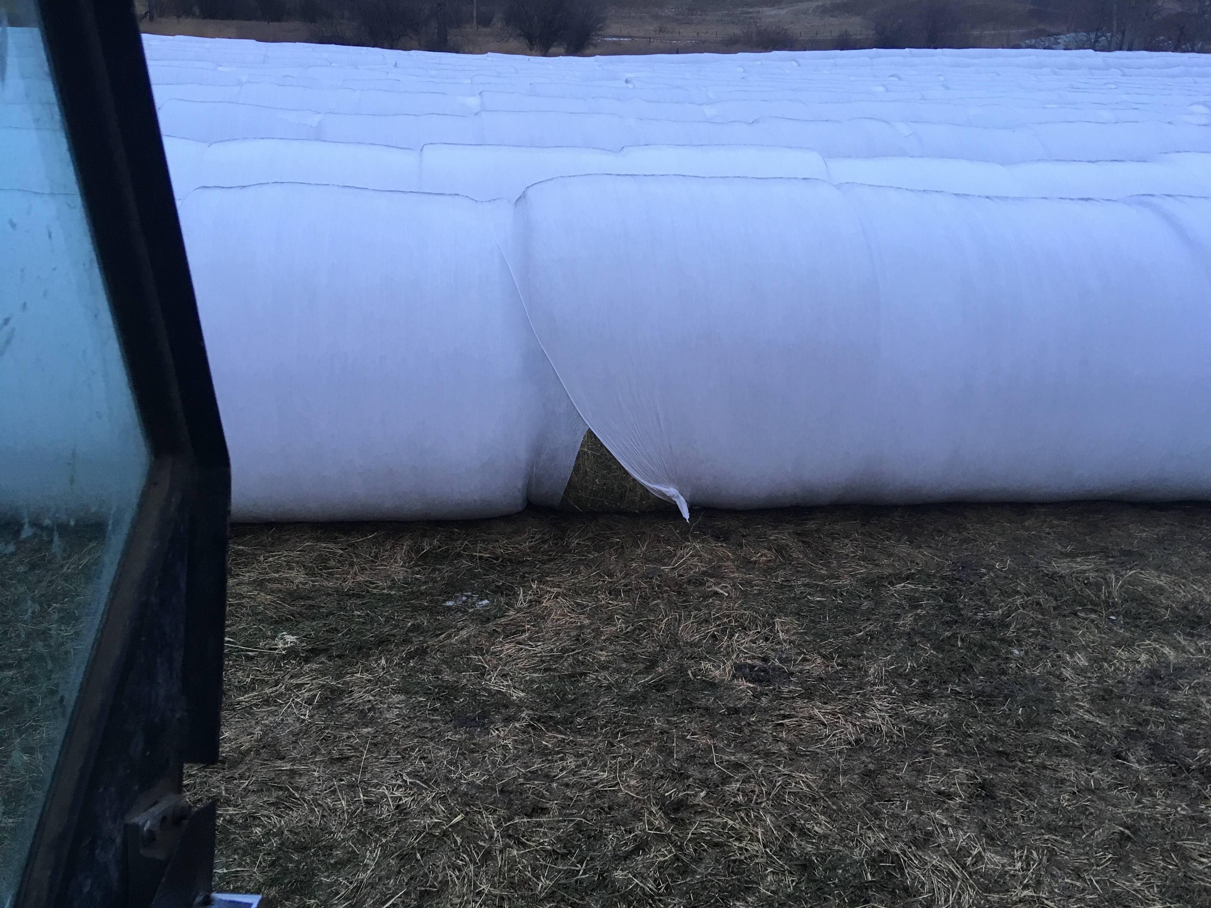

    Got a tube line wrapper here and lately has taken a liking to start removing the wrap off the bales by grabbing it with the carrier rollers under the bales. Drives me nuts as there’s no way to patch those holes. I’ve wrapped the couple of rolls that wrapped on the last line with duct tape and now the others are doing it. Before it would happen every thousand bales or so and now it’s after every 30-40.
    Just curious if anyone else ran into this? Going to pull it in the shop this winter and repaint them but they aren’t bad at all unless someone has a better idea.

    Havent had that happen but are they sticky at all? I'd try washing them if you havent already. When the stretching rollers start causing problems a cleaning helps them. Bearings on rollers still free or are they hanging up a bit?

        You can wash the rollers with alcohol to remove any residues that might be grabbing the plastic. Ruling that out, it might be the plastic brand itself.
          • 1975
          Pulled it in the shop and defrosted the rollers and covered them in duct and tuck tape thinking the rock chips on them might be grabbing the plastic. Cured it for 20 bales and then the same problem shows up. Talked to the plastic supplier and he suggested putting the rolls in backwards. Tried that and it’s done 50 bales so far so good without an issue. We’ve wrapped below freezing before and never had a problem so I’m chalking it up to the plastic brand.
