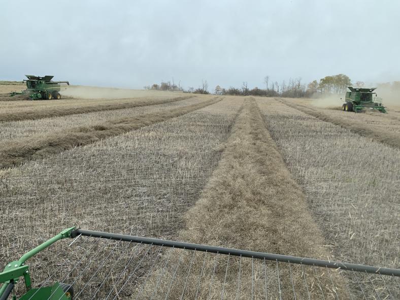

            We use to blow on fines like the case but changed it up a bit.
            Now triple shoot. Dry anhydrous and with the seed.
            Seems to work plant tissue test in august said I had the right mixture.
            Did a soil test for 100 bus canola for shits and giggles.
            I'll leave that for the expert up north.
              Some canola varieties are a real POS.
              fert all the same and 5 bpa difference.
              Dekalb 92sc never grow it..
              Have rep coming next week.
              See What We get..
