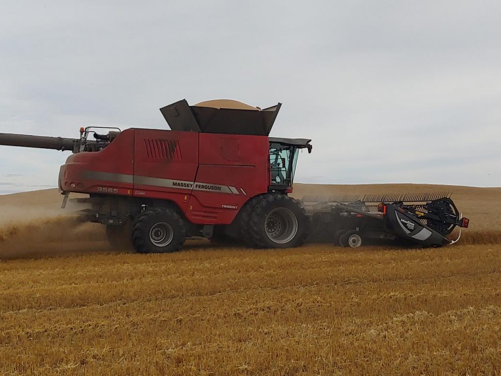

    Wheat is take able , but humidity was at 89% last night by 9 pm
    Was up to 26 gal/hr lol
    Saturday wheat wheat was dry , before the 15 Th rain of this harvest , I averaged 16.5 gal / hr all day .
    The Mav eats some power but still far better than any case spreader
    I am spreading the full 45 ft and everything is chopped very well .
    Kinda hard to see but , it spreading full width .
    The only downside.... was the cost . Absolutely crazy , but we had to do something. Those 1970’s spinners on a class 9 were a terrible joke

    With all the modern tech on these new combines, it utterly stuns me when I drive around and see the number of machines that STILL cannot spread the width of the cut!
      • 22645
      That’s the issue with most North American made combines ... they are designed mostly for corn and soybeans then retrofitted for small grains .....
      there is very very little MOG in corn and soybeans, hence no need for proper choppers from factory unless special order b/S at a huge cost already over a very overpriced corn / soybean machine
      With added aftermarket parts , concaves , rotors , beater , choppers they work ok . But it’s a huge added expense on top of combines way overpriced

          Our Ghetto Massey has a MAV, utterly destroys dry cereal straw. In tough conditions it still chops but most of it isn't pulverized to next to nothing.
          They are really spinning too, chopper rotor balance is very important.
          But ya, quite the chopper.

            Here is a safety tip, remind the extra people on your crew or around the combine DO NOT STAND BEHIND THE COMBINE. My neighbor has a Massey like that, he lost a blade it shot out and they realized the danger of the MAV chopper!

              We used to have a straw storm on a 750 Massey. We were petrified of one of those blades coming out, being that the spin horizontally. Combine always caught up to truck to unload, and truck always pulled away when done.

                    Blades have to properly be bolted in and torqued. There are stepped spacer bushings and a heavy bevelled washer that has to be properly installed. The "slight" bevel needs the convex side against the stepped bushing so the knifes don't bind or break the stepped bushings. If the bushings break and the bolts flop around they can break and shit comes flying out the back. Yup dangerous
