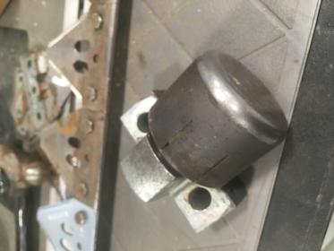

    Knife drive bearing for 4000 series Click image for larger version
ID:	778507 honeybee header , cannot change bearing alone anymore , apparently ?
    $435 or 81 bushels of #1HRSW , when will these greedy bugers have enough ?
    Has anyone found a reasonable replacement ?Click image for larger version
ID:	778507Click image for larger version

        Im technically challenged lucky i got a pic on here at all
        But i havent bought it yet
        Hoping for an alternative

          That bearing is the same as the one used on a JD 936 d****r header and I used to buy Honey Bee bearings because they were cheaper. That is just the bearing, I have changed several of them and used to keep a new one in stock. They are very hard to change, If I remember right I used to take that end cap off and smash the outer and inner race. Very dangerous wear protection every where! You have to locktight the end cap screw when you reassemble. I think the bearing and casting are all standard Shumacker (I may have spelled that wrong). I remember the bearing is special and not just available anywhere. If you really need to know. I am sure I have one somewhere and I can find out more information. I have taken them off in one piece too but it is difficult. Good luck.
          Oh and don't run a loose one or run one with the plastic bushing pounded out or of course you will be breaking knife heads or knives.

            Sorry took a good look at your picture and I see they have changed the way the bearing is retained. I would probably try and get the older style casting that you could change the bearing on.
              • 3958
              Might be the same bearing as the rear wheel on a Chevy Aveo. Chinese version 33.95 online. It don't get any cheaper! 25mmX52mmX37mm
              As pgluca said you have to pull it off the crank. If the crank is okay you will get paid well to pull the bearing.
              New Holland lists bearing for $154. #86565872
              What you have in the pic is supposed to be better than the old style. You would have to change other parts to go back to the old style.
              Also, the style shown in the picture you posted is not serviceable. A complete assembly crank and bearing from Schumacher.
