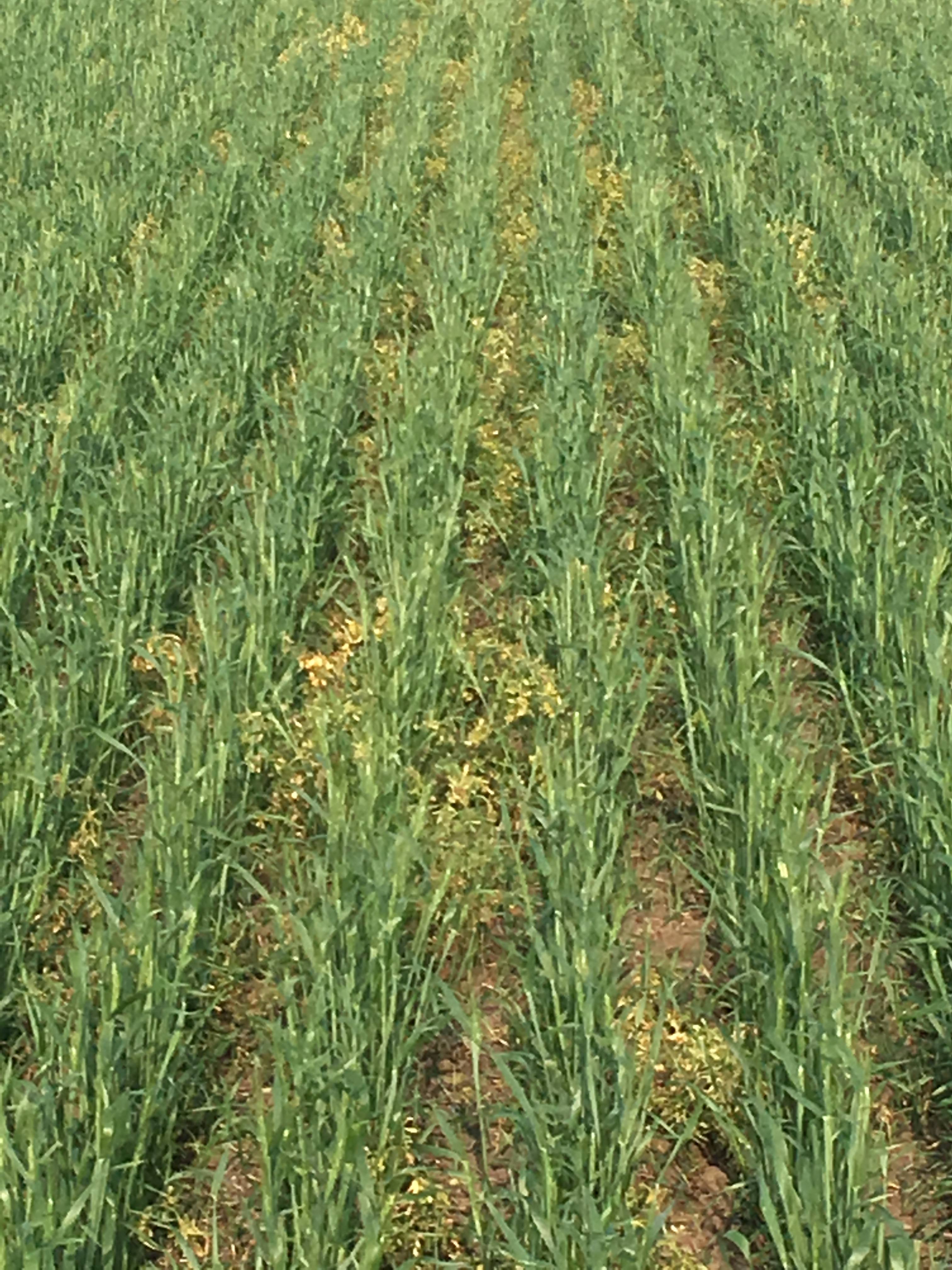

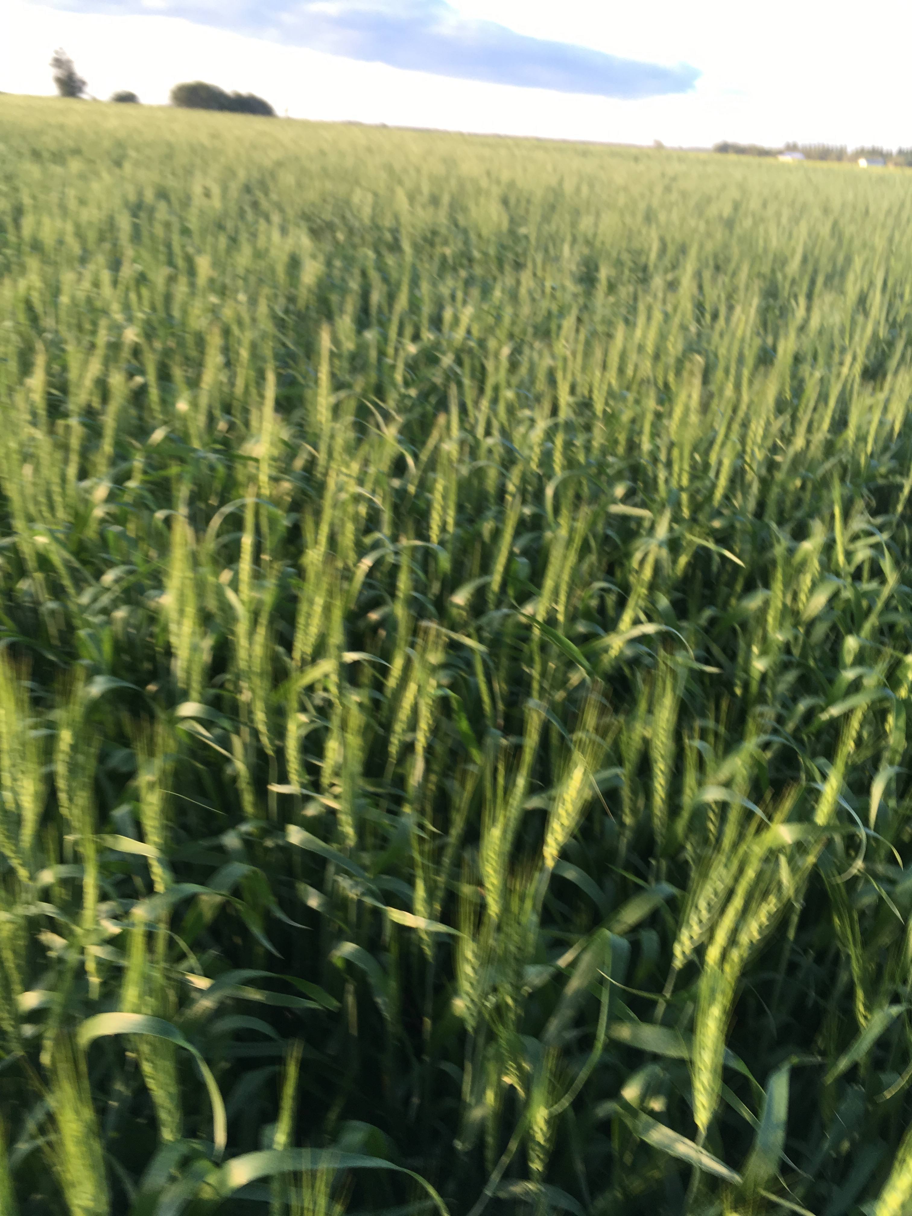

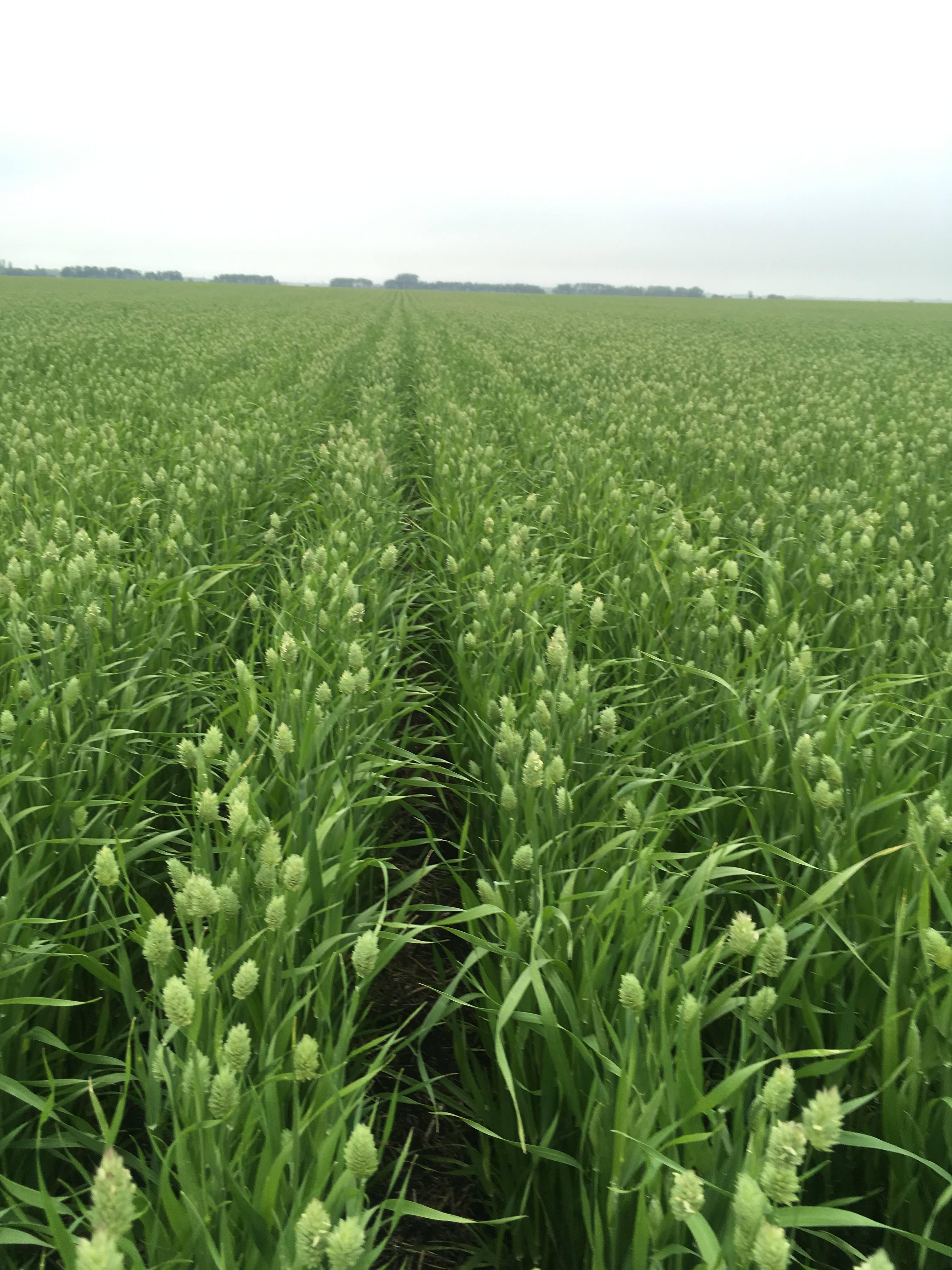

                See and our old morris maxim doesnt have an ipad at all lol
                We had virtually no rain here until weed spraying was near done
                Last pic of wheat seeded on a dried out alfalfa field shows how dry it was here and yet it grew but headed out 8” high
                The only point i am trying to make is that i dont think these new miracle drills pack enough and theyre a lot of money !
                What do others think ?
