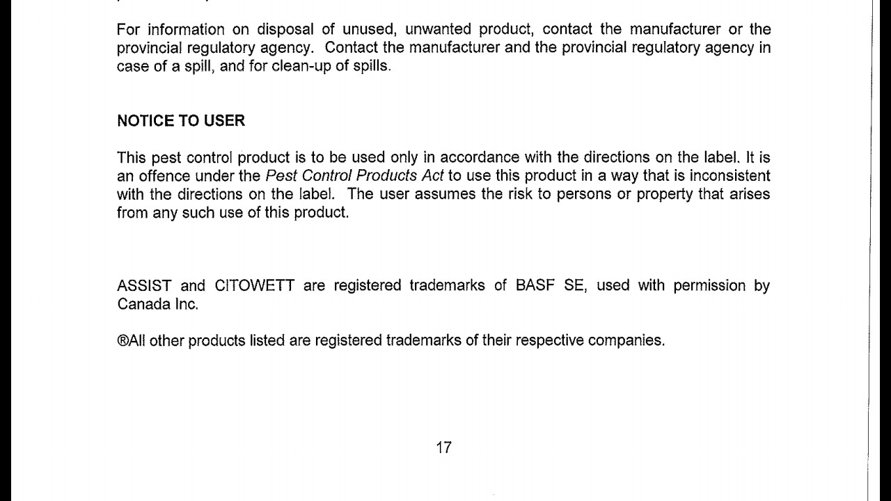

                    Please ignore furrow's illegal recommendation. Max label rate is .91 l/acre or 2.25l/ha. One litre per acre is illegal.
                    Page 17 of the label which is a legal document
