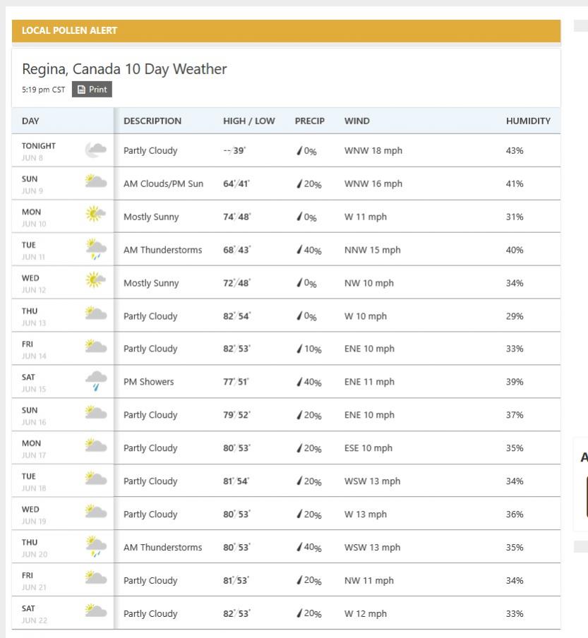

                Everything is up , the odd hard clay hill or sand dunes. Is kinda thin.
                Just need a rain . The area got 1/2 a tenth to not measurable.
                Grand total since the winter snow melted , around 7/10s.
                Good thing it is not too warm this coming week.
                Last chance a week from now.
                I think it will be over if we get
                Skunked again.

Name:	reg weather.jpg

                    It seems the Reddeer corridor and from Weyburn north a bit had a good storm. Some Manitoba but for the most part Skunked.
                    June 23 rd looks like the day. Yea twice in one lifetime.
