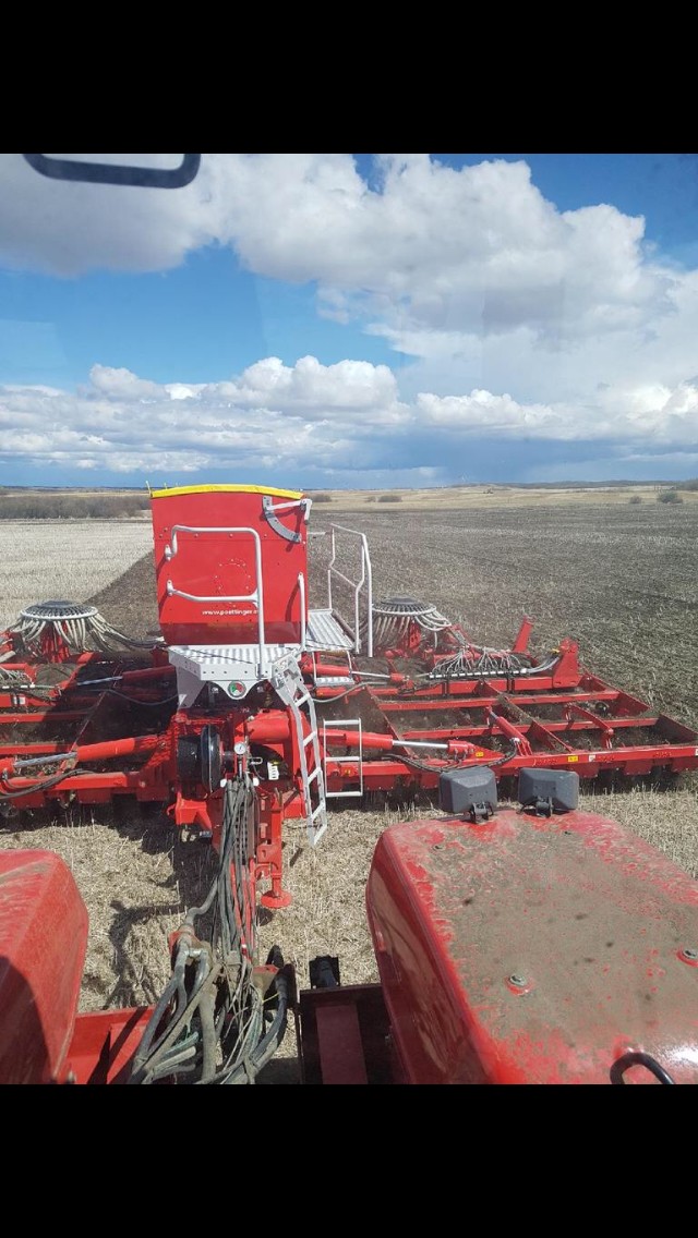

    Friend of ours with his seeding unit
    A Pottinger high speed seed unit . Very similar to some of the equipment that Klause shows on here from South America once in a while
    He used it last year, grew some very good crops with it in very dry conditions.
    • 22719
    Seeding lentils I believe...
      • 9802
      Common style of drill in Europe too where there is less acres to cover. Often because they still plough there they will have a tool on the front linkage to work the land from ploughed state to seedbed to seeded in one pass.

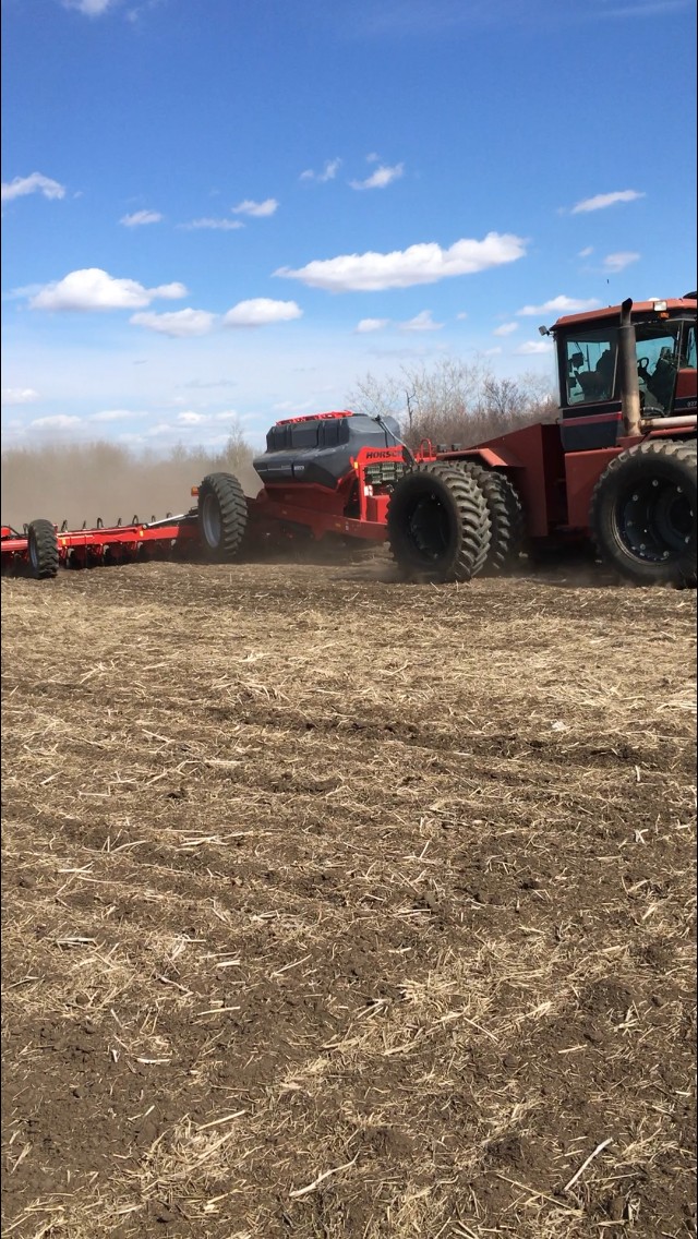

        Trying peas this year with the Horsch ..
          • 17054
          Furrow
          I have been looking online and researching these types of units...do you have a dealer close by that is knowledgeable and helpful?
          It seems that stuff gets to the higher production areas....
          Are they expensive????
          Because the common colours are outrageous and/or poorly built...
          I made a half round with my son at 5.5 MPH and it felt like a jail cell seeding....

              Ya we have a local dealer for the Horsch
              They are good now after 3 years .
              Nothings cheap but they are about 1/2 price of a 70 -80 ft drill with the same bells and whistles. And you need a 600 plus hp tractor .
              But limited to just liquid phos with seed and lots of moving parts.
              Good and bad , Luke most anything out there
              They are very well built and easy to work on if need be

                  Most are designed to precisely seed at 8-10 mph ...... if conditions are right .
                  We pull our Horsch with a 1993 Case 9270. Very cheap hp.
                  • iceman
                    • Dec 2014
                    • 750
                    So I take it you don’t need huge hydraulic flow then?
