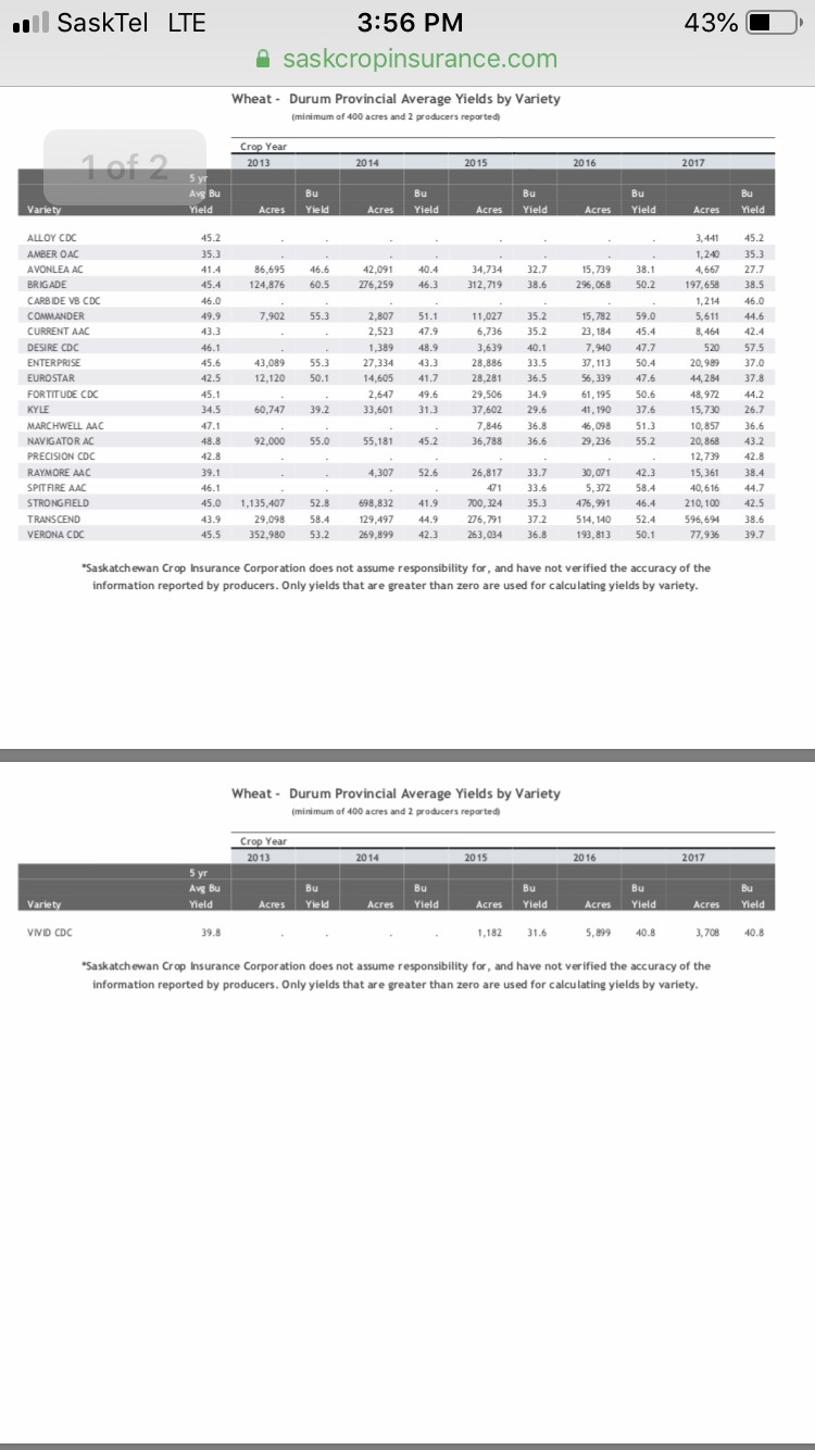

              Look at the acres seeded for Transcend in the above Crop Insurance results, there's a reason for that, good yields and holds it color well after a rain.
