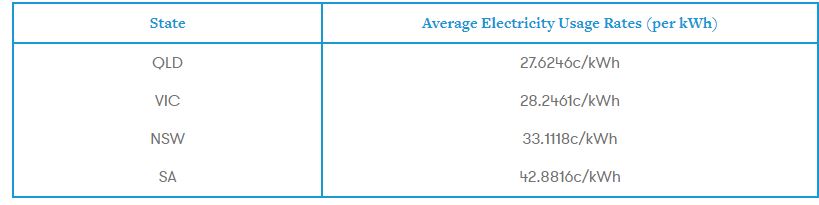

          Think i will have 22 panels for solar and about 40 for solar and battery

            AB5 im not a doing anything other than trying to get cheaper power.
            Not a save the world type or a climate change beleiver just power is ridiculous in SA
            Our power prices have almost double in last 7 years.
            Supply charge is 94 cents per day
            Im not actually saing solar is cheaper when repalacement costs added in, but like i said who knows what grid power will be govt trying to bring in some sort of regualted floor price currently for grid power.

            Mallee,
            Is your kW price the only charge on your bills?
            In Alberta we pay a monthy charge for the power transformer of between $40 and $400 for rural and commercial services, then we pay for the electricty used by the kW/hr and then a transmission charge based on the kW of electricity used and then a distribution charge based on the kW of electricity used and finally a monthly fee to do the bill and paperwork. For example on my energy bill the electricity used might be $100, but the total bill might be $500 once all the fees are included. There is also a carbon tax on the bill which I had forgot about.
            I stand to be corrected, but my understanding in Alberta is that if I have a solar panel set up and also need to use the grid power, I pay full rate on the power the grid provides me including transmision and distribution charges, but once my solar panel starts putting power back into the grid, I only get credit for the power, no reduction in my distribution and transmission charges that occured. Monthly fees for the power transformer still occur at that $40 to $400/month.
            So to really make solar pay in Alberta you need to be totally off the grid or use very little power from the grid. A $4000 yearly power bill might be only reduced by $1000 maximum as that is what the actual power cost is.
            If your $0.20-0.42/kWh is an all in price it is very expensive, but not that much worse than our costs here. If you have to add distribution and transmission charges to your prices, then yes you are getting ****d.
