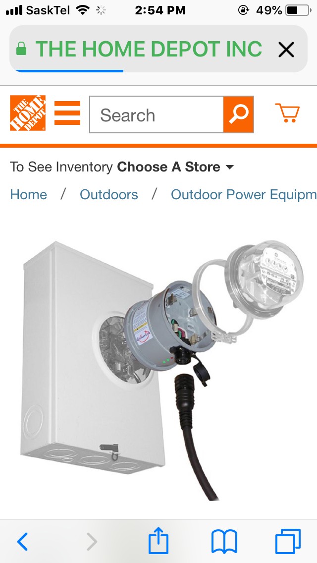

    By law you must have a transfer switch or isolator interlock (cheapest) or simplest is the one that replaces your meter (sask power will supply a farm one for $700) but will not supply urban or towns . In town it will cost you $1100 plus install
    Many people do not know that your transformer will turn 220 volts from your generator into 13000 vac , if main breaker isnt turned off
    Many around here just backfeed through a 220 volt plug and shut main off. Dont think its legal though

        This breaker box can be wired for ether bonded or floating neutral generators.
        https://www.lowes.ca/panel-boxes/square-d-30-amp-18-space-36-circuits-maximum-generator-panel-box_g1437994.html?searchTerm=transfer-switch https://www.lowes.ca/panel-boxes/square-d-30-amp-18-space-36-circuits-maximum-generator-panel-box_g1437994.html?searchTerm=transfer-switch
        and this plug will turn any generator into a bonded neutral generator.
