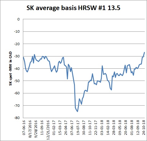

    Wheat basis
    Something to watch
Name:	SK wheat basis Oct 24 18.jpg

              To me, basis has always meant the difference between the futures market value and the actual point in the market where you are going to give up possession (sell) your grain.
              HRSW pricing is based off the MGE spring wheat contract, so currency exchange is a factor. This is handled by the graincos by adding an amount(usually positive) to the futures price (quoted in USD/tonne) to get a delivery point price in CAD.
              I hope my stating basis as shown in the chart above is not too confusing. It is simply using the midweek price released by Sask Ag and converting everything to CAD funds.
              So, this past Wednesday the price released by Sask Ag was $248.55 CAD. MGE Dec contract closed at $5.6925 USD. Exchange was .7597(or thereabouts). Work it all out and you have a basis of -26.7739
              This is the best value seen in a long time. I would have to research when the last time was. There are better cash offers out there than 248.55 too.
