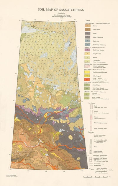

                • 17499
                This map probably says it all. Remember lines have to be drawn some place and at those boundry lines are "grey areas of transition". Area moisture has a huge impact on soil development over time.
                  N is dismal in my fields. How much mineralization(?) can I count on? There is enough residue on some fields and has been for a while, I would think it has to be cycling for years already.
                  That's where your soil micro-biology is important. The living things under the soil are what convert the residue for you. My cows convert a crop into residue these critters feed on and they in turn feed the soil. So many people view the soil as a dead medium to put the seeds and inputs into every year to grow a crop which they then remove. It's why we try to keep something growing in the soil every day we can and why we avoid chemicals wherever possible as they kill the underground workers.
