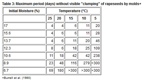

    The chart says 3 - 4 weeks at that moisture and 5 c it was reading 15-17 this afternoon when we ran a test hoping to get it to 14mt before we go as that gives us some time to get to it but not sure if thats in the cards this year.

            • 3959
            seed temperature very important
Name:	Moisture Temp Canola chart.jpg
              We will bag for good if canola gets to 11.5 and probably not dry.
              Two more days of HRS then canola will start at 20 and down for moisture.
              If the temp stays like yesterday you'll get your 10 days bagging then dry. But don't decide to oh I should do other things and dry in a few more you might get a smelly surprise.
              Binned canola and aeration is a joke. It will go boom on the coldest day in December after a two day warms up to zero. or mid-January.
              Here is a quick explanation. When we are drying 20 moisture canola the wet bin is cleaned empty after every two days because it will have build up inside that is already starting to try to heat.
              Two days.
              Yea its great to be done harvest and Input Viagra is happy you achieved the goal but the reality is lots more will be lost in bins and bags that were left in the field.
