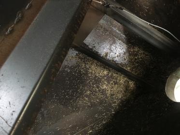

ID:	766812Click image for larger version
ID:	766813here you go poor boy
            Went in at 14.5
            5 nights heat and fan
            6 days fan only
            Came out dry and this is all that was stuck
