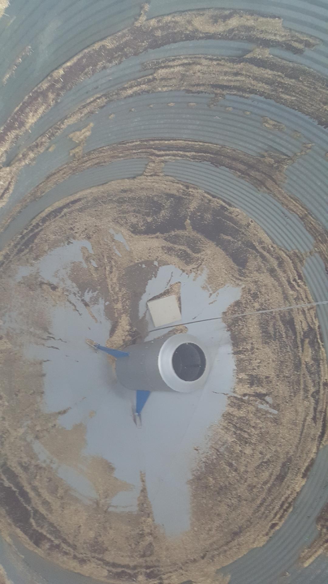

                    • TASFarms
                      • 1397
                      Do you get lots of temp increase alarms in the summer with the temp cable that close to the rocket?
