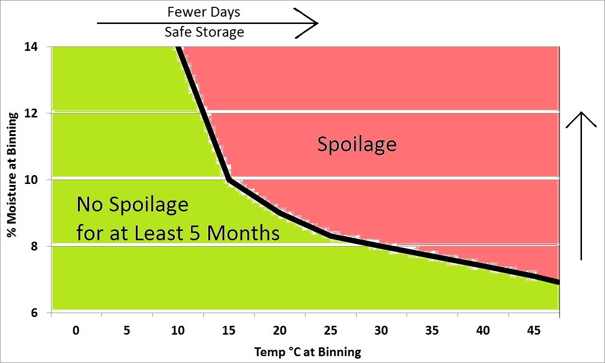

                I once tried to use that chart, turns out it stops long before 20% and doesn't go below 0C so isn't much help in our extreme conditions...
                  • 1976
                  Kinda like the past two years and this year possibly if it ever straightens out. If not it’ll be dry in May when ours will likely get done. Currently raining again here.
