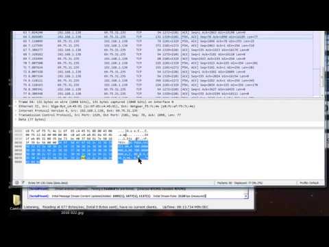

      WD9, how does the ublox base communicate with the rover? Does it need to be over IP or do they offer some kind of LoRa radio communication between them? Thanks again for all your hard work on this!
      • wd9
        • Nov 2000
        • 3196
        ArduSimple has a kit, 2 of the new dual frequency ublox GPS receivers, Xbee transmitters for 10 km claimed (probably a couple km in reality) antennas for 1000$. So that would use just radio connection from the base to the rover.
        The other way is as you say, having the base spit out its RTCM correction to a server and on to the internet, and a cell modem receiver in tractor/rover. The NTRIP client in AgOpenGPS takes the corrections from the internet and sends them via the serial line connected to the gps rover.
        So its, ublox F9P as a base to a "Snip Caster" connected to the internet. The NTRIP client in AgOpenGPS takes the correction from the internet and sends to the ublox F9P as the rover and corrects its position to within a cm and voila, you have RTK. (Like towards the end of the video where I use my home network instead of using the internet/cellular network - but its just a network)
        Hope this helps!
