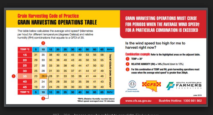

              We have laws and a harvest code of conduct.
              Every harvestor must have a water fire extinguisher and foam extinghuiser mounted on combine. usually somewere near steps.
              A fire fighting unit of 1000 lt must be in paddock at all times either on a trailer or back of a ute/pick up.
              Fire extinguisher mounted on augers.
              A shovel mounted on harvestors as well.
              Harvesting should cease when wind speed exceeds the centre figures hope you can get you head around it.
              Insurance companies go by it now, not law but may as well be
                Try this one full attachment
