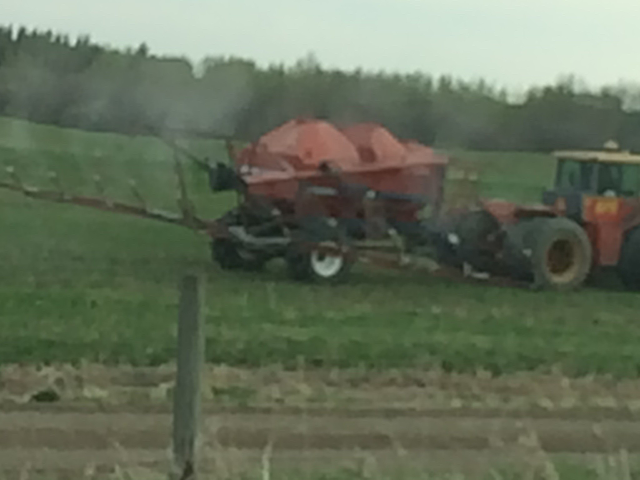

      Built a removable 75’ floater bar for the back of a 300 bu tank and it’s more accurate and faster than a spinner. Works great for floating alfalfa and canola seed in a hurry too.
