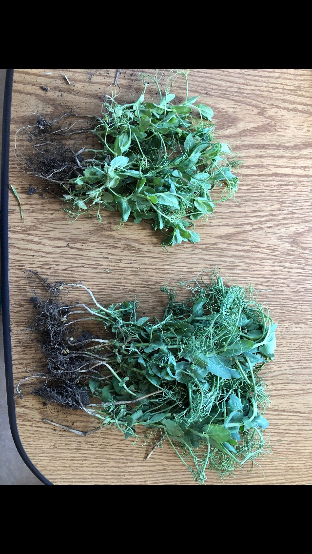

    I have been careful with the rotation but the peas are ****ed. Roots are pinched brown and woody....just ****ed ....very frustrating because I had been letting them get over the odyssey flash...
    That one rain of an inch in ten minutes really ****ed them up when I thought it would pull them through..
    Tough lesson but wtf ....next year.

      Field on left in trouble , 6 years rotation
      On right is fine ,no issues at all , 7 years
      I have now seen 5 pea fields within 4 miles just the past 3 days going down hill
      Frustrating to say the least .
      Always after herbicide application
      This time we did get a rain , the 1.5 in 8-9 days ago .
      Can’t imagine what’s happening in the wet areas ..

        Again , predominantly on wheat stubble
        Green peas seem worse again as well over yellows .
          • 22526
          Sent tissue samples away today from good peas and infected ones .
          Looking to see if there is a manganese difficiency in the infected peas .
          That will tell part of a story .

            two years ago we had 39" of rain . fields were never dry all year .never had any trouble or saw anyone have any trouble . there were drowned out spots , but still managed to yield 40-45 after all that . some were under water for a bit but it was in the middle of June after spraying . I think there's a lot more to it than water . we use half rate of pursuit . I can't believe how hard viper is on them . have never used it . some viper fields still yellow a week later. also curious why anyone would grow peas after wheat when you can reverse that rotation and get high protien wheat every time ?

                  I had no yellowing at all after spraying
                  I used Viper with NRG caB ... 10% calcium both fields .
                  A combo that has worked well before
                  I should have tested the disease levels first before seeding
                  These two fields were far enough away from the last time we seeded peas I did not think an issue .
                  Neither field ever showed symptoms before.
                  The good peas , are on a field we’re we has soybeans 2 years ago.
                  I had peas that looked similar to the left ones last year that recovered and still produced 42 bus . Not great , but not a loss. Put a micro nutrient on them last night that contains mn, hopefully that helps .... it did last year , but every year is different. Still very odd we see it so prevalent again After just one rain event and after being so dry in May .
