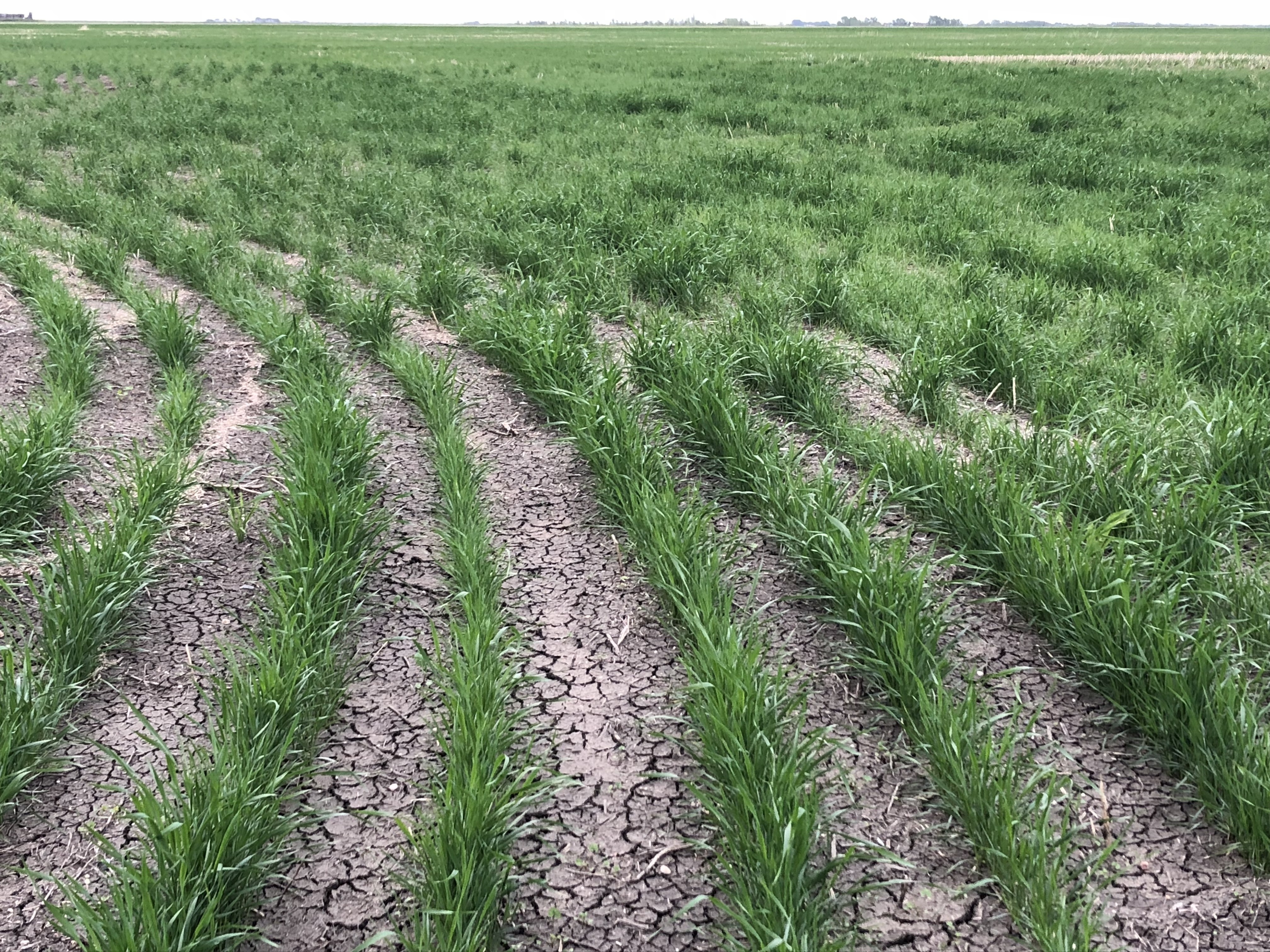

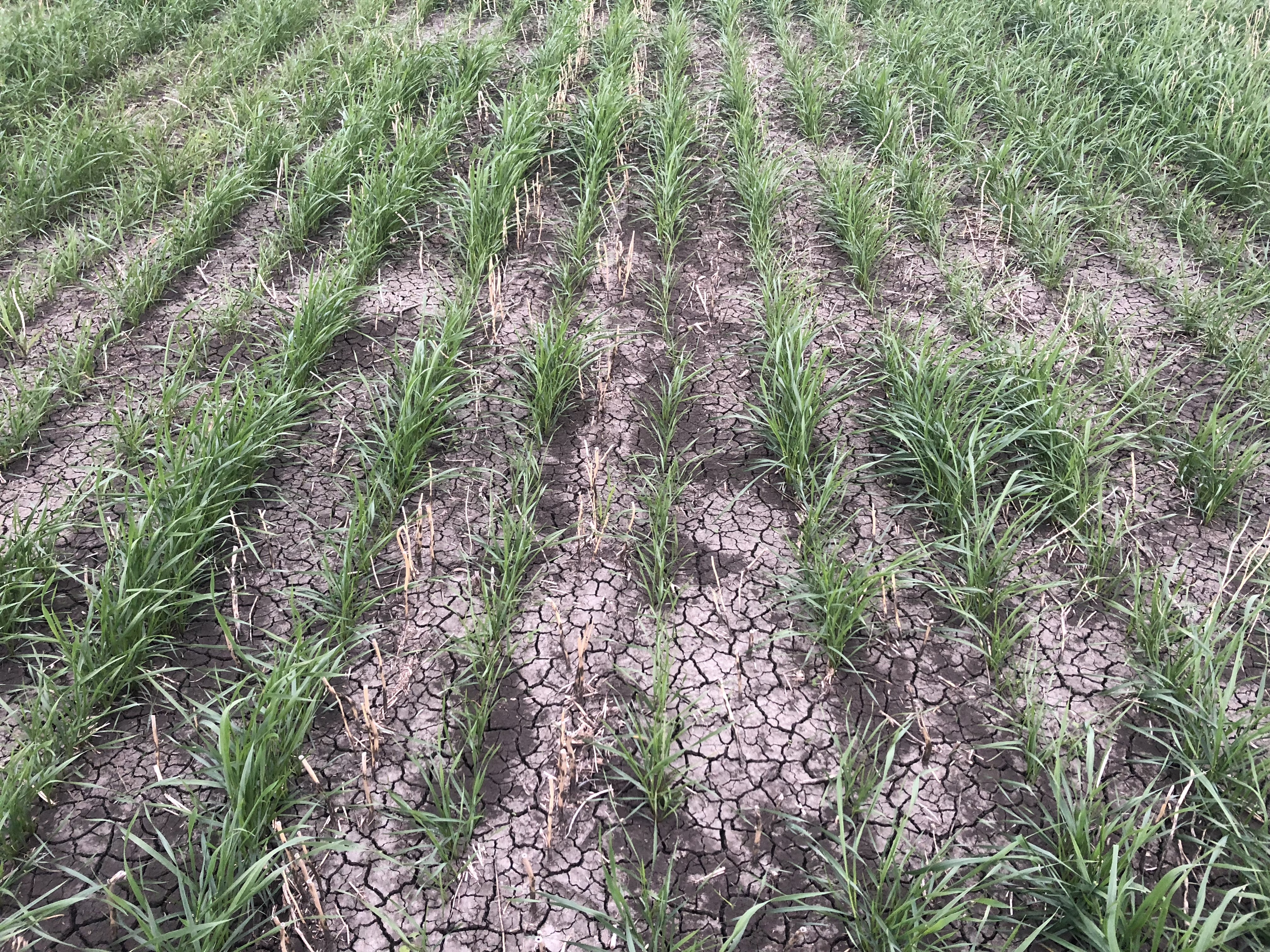

    Very unusual patchiness in our durum. Was very dry at seeding time.
    Any ideas? Low oxygen/compaction?

      Could be compaction. Maybe salinity, group 2 loading, micro deficiency?
      Just guessing

        Gumbo - need good old-fashion discer. 🦍 When my father came to the Regina Plains, he came with press drill in tow and he was going to show the Frenchies how to farm. His brother was already here for a couple of decades and was an inventor who put seed and fertilizer boxes on discers and was pulling several in tandem. Well to make a long story short, after 3 years of wet ground, Mike was pulling discers until he retired. Not all soils are the same and when gumbo gets wet and packed, it is like See-Ment in wet years.
          Gumbo is gumbo I agree. Look at it every miracle cure is great but it's your ground. You can spend, hell could but some 12 dollars more on my peas to make them look good after the rain. Yield will be maybe a smidgen more come fall but would look good fast.
          Next year country.

            Nitrogen toxicity, too much salt too dry, poor seed stock. Looks like lentil stubble was it heavy harrowed and blow baddly.

              I think it is gumbo compaction issue. We were so dry all winter that I don’t think the ground even froze. We barely could get the drill into the hard ground this spring.
              Could it be Liberty residue? Bone dry More likely to leave residue.

                Have similar patchy emergence problem with most of our crop.
                Think heavy harrowing to facilitate direct seeding made problem of soil movement from heavy rain with driving wind cause surface puddling and similar soil surface to shown in photos.
                Still hoping crops will grow out of patchy emergence.

                  ive got patchiness in some of mine on pea and lentil stubble. moisture at seeding was adequate. moisture so far has been adequate. Crop is visibly stunted, thin, curled leaves... I figured its a confluence of stressors. Odyssey hangover on the lentil stubble is the chief culprit, but has anyone ever had viper carry over? 2nd stressor is high nitrogen in the seed row. Without the residual chemical stress, it probably would have been fine, as everything else seems to be, but odyssey seems to have winged it, and seedbed toxicity has compounded the problem... if the tap shuts off in July, who knows, maybe it'll be my best crop, since it's already thinned out!

                    Liberty can have a residual ?
