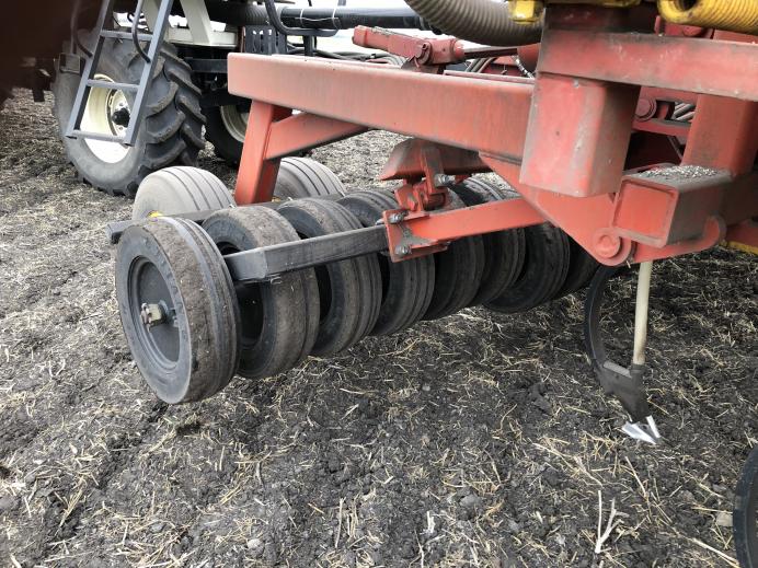

        That would be my 5710...Click image for larger version
        Never had them go flat in 8 seasons. Ruined one due to rocks jamming between them against bearing arm.
        Not hard to take gang apart be the sidewalls are so stiff it is a nightmare to change the tire!
