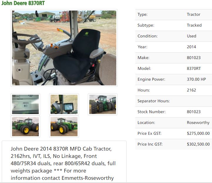

    Currently getting my farming plant together have gone new rogator 1300 b huge discount as 1300c are out here in australia now.
    1830 60ft seedhawk had seedhawks last 6 years so know there good points and bad this one would have to be in the best condition ive ever seen for a 11 yr old machine. Easy working conditions
    Now looking at a John Deere 8370R 370 hp bear in mind we have sandy soil easy working will this pull the above rated at 370 hp. Can they be chipped up?
    Do they have ad blue.
    A mate traded one unbeknown to me with 2100 hours im looking at it.
    But will it opull the 60 ft and can shift the shanks so there in line which makes seedhawks easier to pull

      Reckon this would be $50/60 k more than you would pay in canada.
      And ps its not tracked clerical stuff up

            Usually RT means track model so add is a little misleading. These still have the 9L in it so imagine that it is right at the top as far as power output. No replacement for displacement in the pulling business. Would not pull 60 feet of seedhawk with that here. Why would you put the shanks in line when the whole point of the seedhawk is vertical and horizontal seed and fertilizer separation. Since you usually top dress fertilizer later a single shoot machine would be simpler and cheaper. When shopping for used equipment everything except exactly what your looking for is available. BTDT.

              That's a big Mechanical Front Wheel drive! Why not a straight 4WD?
              Would it want to "hop" in a hard pull?

                does it have the fancy front end. That will help with hop.
                Why not a track?

                  We have 550hp for our 60ft seedhawk and we wish had 650.

                    Gumbo or light land, hills, grain tank size, liquid or ammonia tanks in tow? Some variables. But I have a hard time believing that 370 hp is going to pull that 60 ft drill.
                    Mallee, you could get a decent 4WD for the price of that MFWD. I think. Or do you want it for other uses too. But I think you will be awful frustrated if you short yourself on pulling power with the seeding tool.
